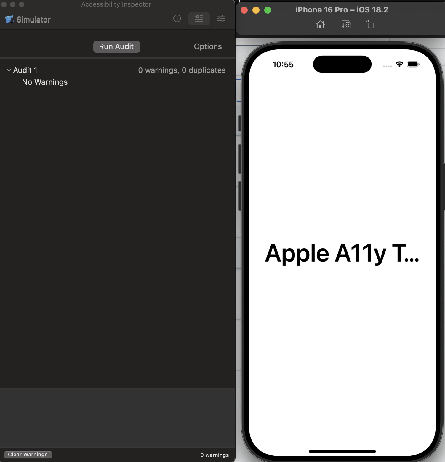

I have an issue on Apple accessibility audit, the text is truncated but can't see the issue in accessibility inspector app
How can I fix the truncated text issue reported by the Apple Accessibility Inspector? I created a sample view controller with the system font set to its maximum size, and the label appears to be truncated.
    private let testLabel: UILabel = {
        let label = UILabel()
        label.text = "Apple A11y Tes"
        label.textAlignment = .center
        label.numberOfLines = 1
        label.adjustsFontForContentSizeCategory = true
        label.font = .preferredFont(forTextStyle: .headline)
        label.translatesAutoresizingMaskIntoConstraints = false
        return label
    override func viewDidLoad() {
        super.viewDidLoad()
        setupUI()
    private func setupUI() {
        view.addSubview(testLabel)
        NSLayoutConstraint.activate([
            testLabel.centerXAnchor.constraint(equalTo: view.centerXAnchor),
            testLabel.centerYAnchor.constraint(equalTo: view.centerYAnchor),
            testLabel.leadingAnchor.constraint(greaterThanOrEqualTo: view.leadingAnchor, constant: 25),
            testLabel.trailingAnchor.constraint(lessThanOrEqualTo: view.trailingAnchor, constant: -25)
What is the expected result here?
Hi, it looks like the Accessibility Inspector failed to find a clipping issue in this case. Could you please file a Feedback Assistant report? The sample code was very helpful, thank you!
