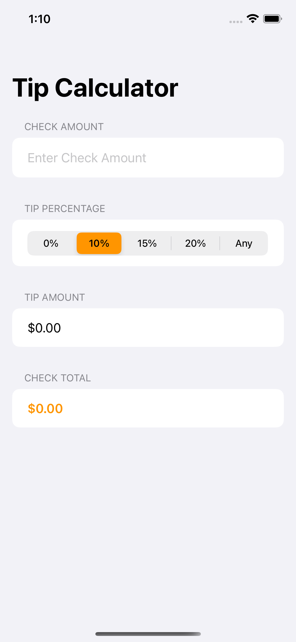

I wanted to see if someone with more UIKit experience than me can help me out on guiding me in the right direction for conditionally adding and deleting a row in a UITableView.
What I Want to Accomplish
I have a tip slider with percentages (0% - 20%) with a custom option on the end. I'm wanting to, when the custom option is tapped, bring up a row immediately below there and have a UITextField. When another option, let's say 10%, is tapped, I want the text field row to go away.
Can someone explain to me how this would work? And if so, provide an example?
Thank you!

My tip percentage slider is a Segmented Control, with options ranging from 0% to 20% and then 'Any' is the custom value. When the user selects the 'Any' value, I want to be able to have a TextField appear below it, and then disappear when the user selects a value other than 'Any'.
if (isTipPercentageCustom) {
// Show the Text Field
// Perform calculation, etc.
} else {
// Hide Text Field
I want to create it once, and then just keep showing and hiding it since I have to keep it in memory until the app closes.
Is this even possible with a Segmented Control?
Does that clarify it a little bit?
