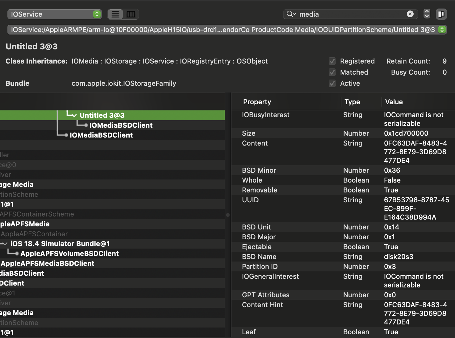

(For reference, the partition represented by disk20s3 has a Content Hint of 0FC63DAF-8483-4772-8E79-3D69D8477DE4 and Leaf is True which I verified using IORegistryExplorer.app from the Xcode additional tools.)
