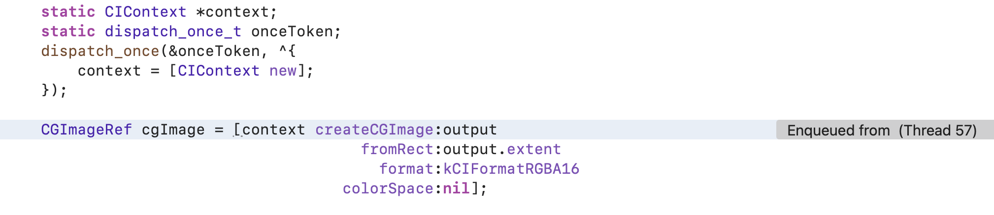

We have some rather old code that worked for many years, but recently started to crash sporadically here:
The crash looks like this:
or
Our code is called from many threads concurrently, but as said it worked without any issues until recently.

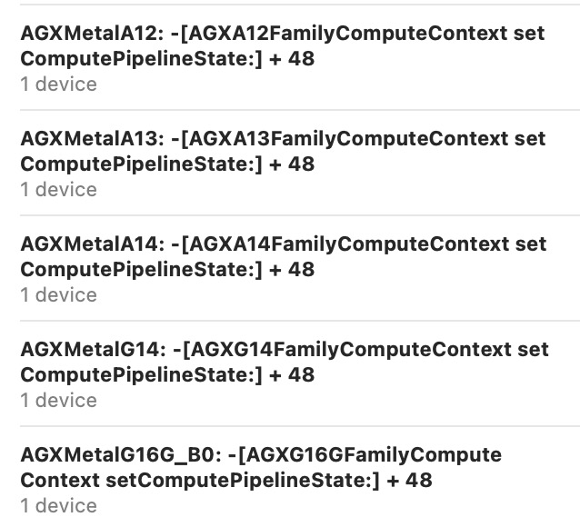

Same here. It might have started with iOS 18.3 though.
I’m not sure what you’re trying to convey by this screenshot, but let me clarify what I said earlier:
if [you] do see a crash like this that doesn’t involve Xcode, I’d love to hear about it.
I was hoping you’d tell me about it and include a crash report, or the number of a bug to which you’ve attached a sysdiagnose log or a crash report.
