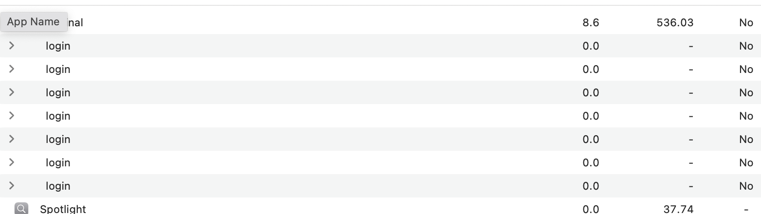

Here is an example of what confuses me: the total is 500 units, but each of the windows has 0.0 units.
That's not what's going on there. It's showing the process hierarchy and the Energy Impact is per process, not cumulative. Also, not that "0.0" really means "didn't use significant power", not "didn't use ANY power".
Using Terminal.app as a convenient example, I have it open with a few windows, one of which is running "top". What Activity Monitor shows is:
Terminal.app = ~10
-> This is the normal app management "cost".
  login = 0
-> login creates the environment the child shell operate in, but doesn't really "do" all that much.
    tcsh = 0
-> Similar to login, the sheet interprets command line input and defines the environment the tools it launches operate in, but doesn't actually "do" all that much when another command is actively running.
      top = ~100 -> ~150
-> This is basically polling the kernel for process state updates, so it's relatively "busy".
