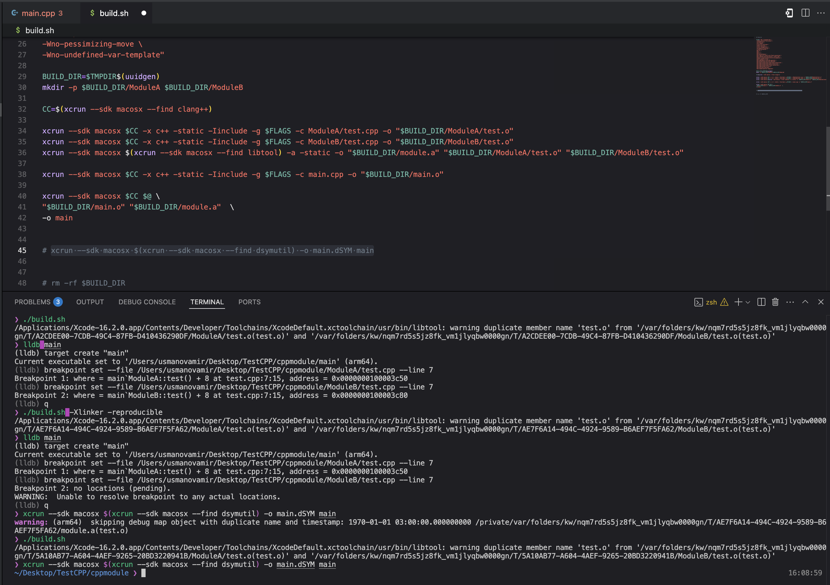

Hi! For example i have library with structure like ModuleA/test.cpp, ModuleB/test.cpp, then i build it like:
#Building library
clang++ -c ModuleA/test.cpp -o ModuleA/test.o
clang++ -c ModuleB/test.cpp -o ModuleB/test.o
libtool -o module.a ModuleA/test.o ModuleB/test.o
#Now reproducing build steps from Xcode
#Compiling...
clang++ -c main.cpp -o main.o
#Linking...
clang++ -Xlinker -reproducible -o main main.o module.a
Now if we launch lldb main, we cant set breakpoint in file ModuleB/test.cpp, only in ModuleA/test.cpp, if link without -Xlinker -reproducible, both breakpoints working as expected.
Also dsymutil completely delete symbols for "duplicate" library if link with reproducible flag.
It's just example, in real static library i can't change behavior of building process, and can't change names of producing object files.
Xcode always set -Xlinker -reproducible flag, and i don't know how to disable it, and my debugging process partially broken.
ENV: macos: 15.4.1 Xcode: 16.2

I tried reproducing this here in my office and hit some snags. The example you posted as text (as opposed to the screenshot) doesn’t make sense because you didn’t include debug symbols (-g). It also doesn’t include the -a flag to libtool, which is likely to be important. I then tried to follow what you did in the screenshot and… yeah… I’m not sure I’m doing this right.
Can you post a more fleshed out example? Specifically, I’d like to see the contents of the C++ files you’re compiling (ModuleA/test.cpp, ModuleB/test.cpp, and main.cpp).
Hi! Here's full example
