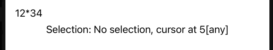

The example code below shows what I am trying to achieve: When the user types a '*', it should be replaced with a '×'.
It looks like it works, but the cursor position is corrupted, even though it looks OK, and the diagnostics that is printed below shows a valid index. If you type "12*34" you get "12×43" because the cursor is inserting before the shown cursor instead of after.
How can I fix this?

I cannot reproduce your issue.
In simulator, when I type
12*,
  * is immediately converted to x
Then I end typing 34 and get 12x34.

That is strange. I consistently get the error. I am running macOS 15.4.1 (24E263). I've updated the body variable in my original example to print out all the changes (see further below, from line 7). With this change, I get the following output:
input: changed from '' to '1'
input: changed from '1' to '12'
Moving cursor from 2[any]
Moved to 4[utf8]
input: changed from '12' to '12×'
input: changed from '12×' to '12×3'
input: changed from '12×3' to '12×43'
Note line 3&4 where it replaced '*' with 'x'. When I then continue to type '3' and '4' you can see the output changes to "43" instead of "34".
