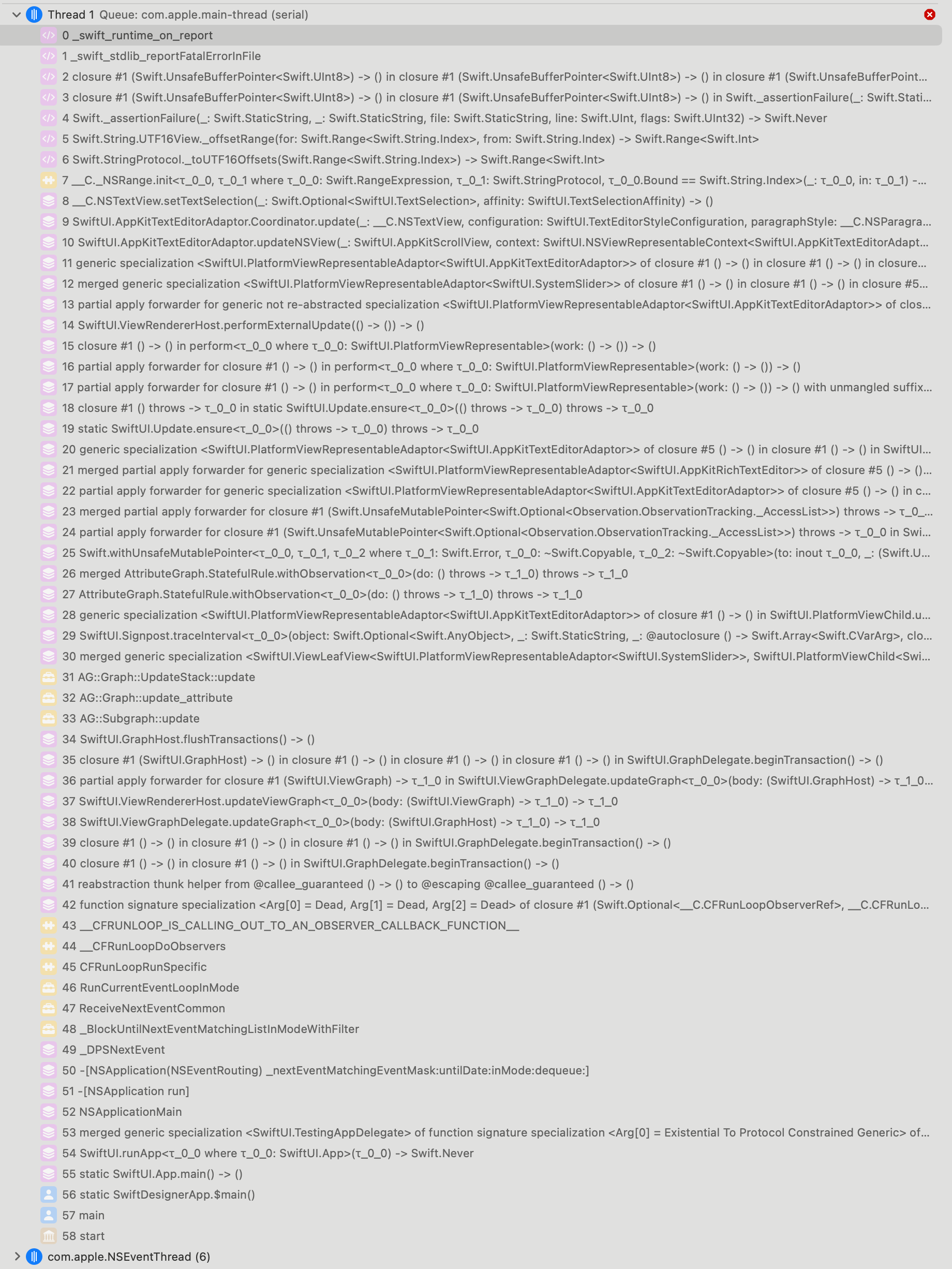

Similar experience on macOS.
Using TextSelection with a TextEditor is very unstable and crashes quite easily, especially if the selection is used to mutate the string bound to the TextEditor. (Which is common for operations that involve replacing the selected text.)
In Xcode, the following error is reporting in the console:
Swift/StringUTF16View.swift:372: Fatal error: String index is out of bounds
The full call stack is pasted below

Unscientifically, it feels like this happens much more frequently in an AppKit application hosting a TextEditor than it does inside a SwiftUI application.
If I make a demo SwiftUI app with nothing more than a ContentView and a TextEditor, then it's harder to trigger this bug (but not impossible, as I just did it). On the other hand, when used inside a much larger AppKit app, it happens quite easily even though the actual SwiftUI code isn't that different. 🤷‍♂️
