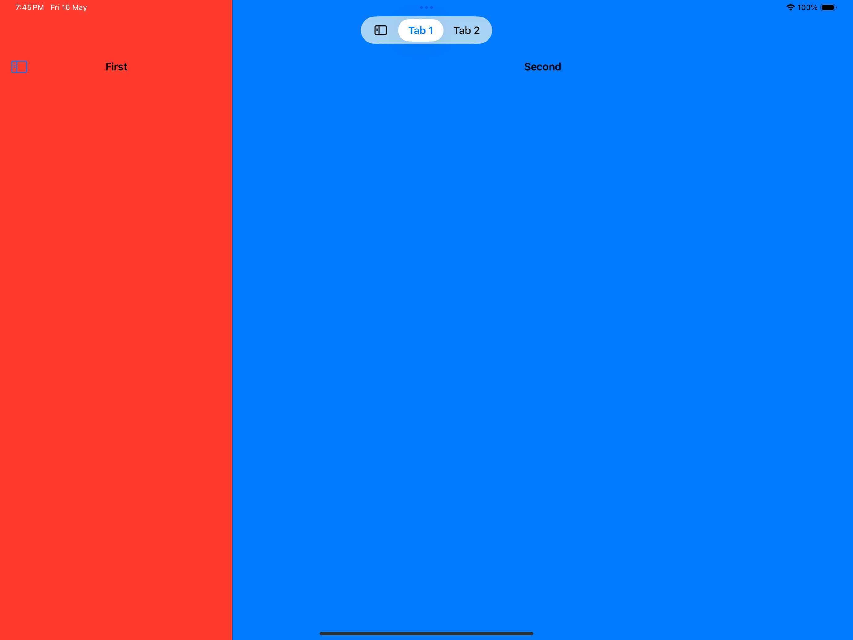

I'm developing an iPadOS 18+ application that uses a UITabBarController, styled as a sidebar, to serve as the primary navigation interface. This setup includes 20 different tabs, each representing a distinct section of the app.
For the user experience, each tab needs to present a master-detail interface, implemented using a UISplitViewController. The goal is to allow users to navigate between tabs via the sidebar, and within each tab, access related content through the split view's list-detail pattern.

Currently, my implementation involves instantiating a separate UISplitViewController for each tab, resulting in 20 unique split view instances embedded inside the UITabBarController. While this works functionally, it leads to significant memory usage, especially after the user opens each tab at least once. The accumulation of all these instantiated view controllers in memory eventually causes performance degradation or even memory warnings/crashes on lower-end iPads.
