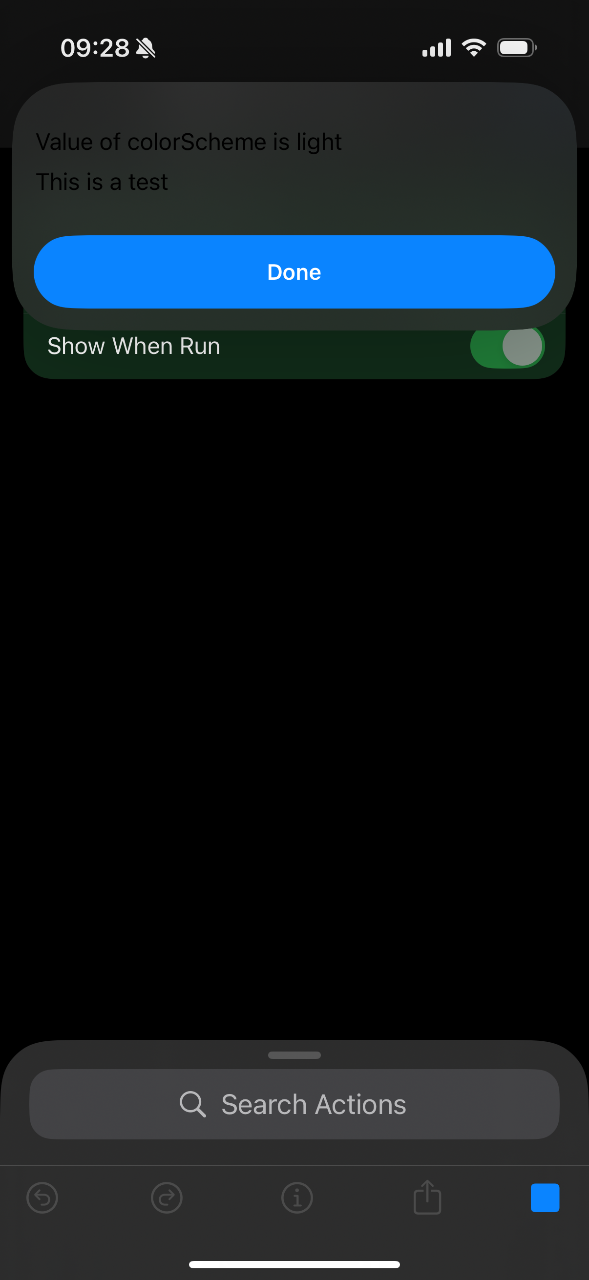

I have an App Intent that conforms to ShowsSnippetView and returns a view that is shown in the Siri interface after the shortcut runs. The view simply consists of a VStack with a Text element, with no special styling. When my device is set to dark mode, the view doesn't adapt: the text is black, but the background of the Siri interface is a transparent dark gray, which makes the text almost unreadable. The text should be white in dark mode. The colorScheme environment value inside the view corresponds to light mode, even though the device is set to dark mode. This is most likely a bug in iOS.

@DTS Engineer , I don't see anything in that view that is different from what I already have:
struct ResponseSnippetView: View {
let text: String
VStack(alignment: .leading, spacing: 8) {
Text(.init(text))
.padding()
.frame(maxWidth: .infinity, alignment: .leading)
As I mentioned, the text appears black in dark mode, not white as in the screenshot you posted. The colorScheme value inside the view corresponds to light mode even when the device is in dark mode.

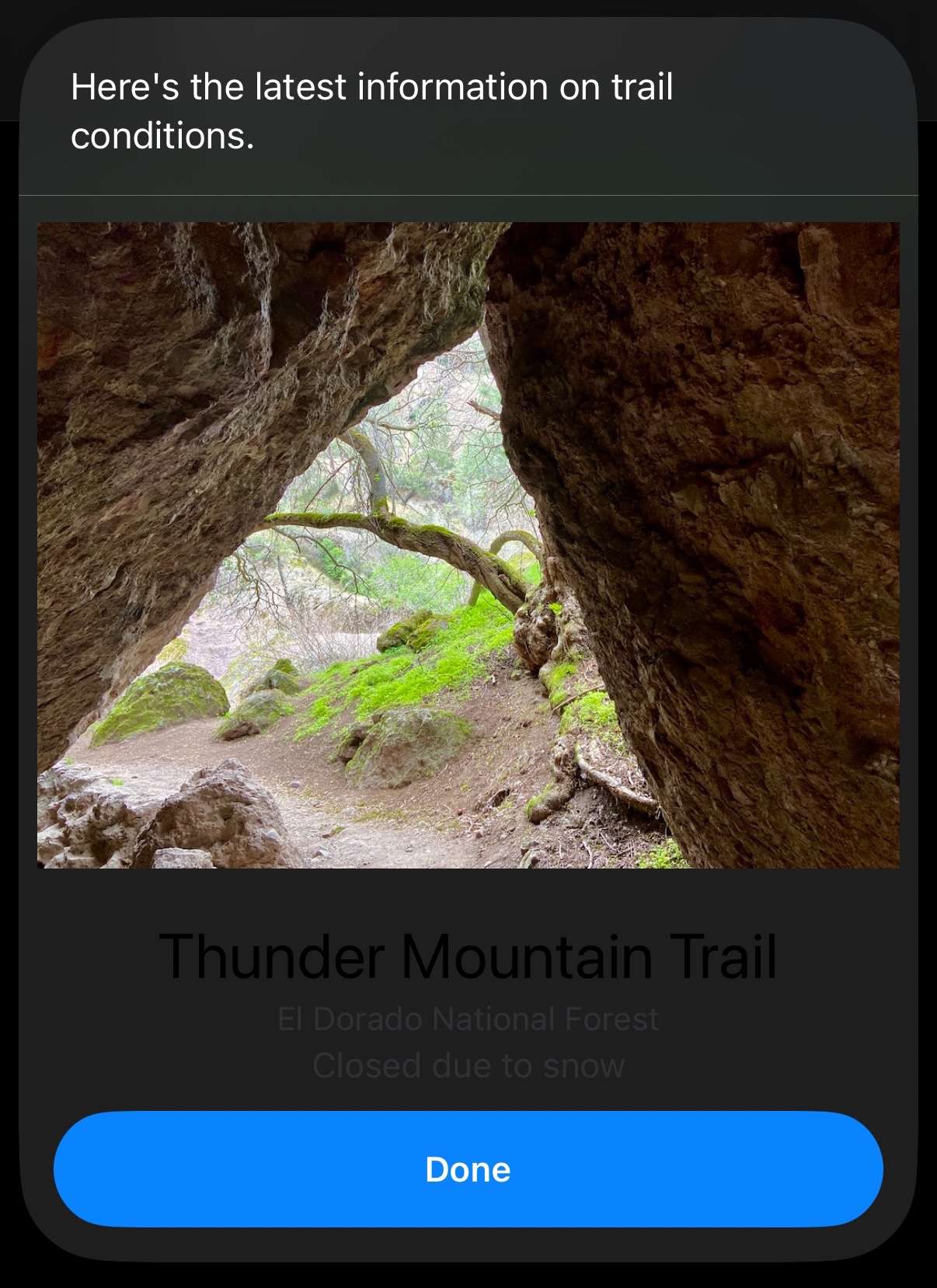

What iOS version are you testing on? I shared a screenshot that shows a snippet in dark mode, straight from one of our published sample code projects. If you run that same sample code project on the iOS version that you are testing with, do you see the exact same thing as in my screenshot?
I looked at your project (thanks for opening up the GitHub link), and if I run the project without modifications, I cannot reproduce your screenshot on iOS 18.5. I've attached the screenshot from your app at the end for the record.

I'm running iOS 18.5, and the snippet view is still showing the light colorScheme environment value in dark mode, with black text instead of white text.

The snippet from the sample app is also not displaying properly in dark mode.
Ah ha! If you can reproduce this with the sample project on your device, then this behavior is a bug. The sample's implementation of that view is the correct way of handling how a snippet view may be rendered in either light or dark modes. Since you can reproduce this but I can't, it would be helpful for you to file a bug report. including that screenshot as well as a sysdiagnose. (And please post the FB number here for the record.)
