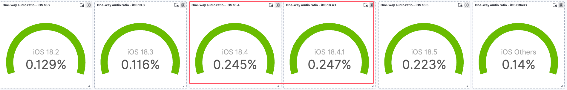

We've also double-checked and confirmed that there is no early activation of the audio session before CallKit is expected to activate it. Despite this, on iOS 18.4.1, we’re seeing a statistically significant increase in the failure rate of didActivate, as shown in our metrics.
Given that our app version remains unchanged, and the issue correlates strongly with the iOS 18.4.1 system update, could you help us further investigate whether there might be behavior changes in AVAudioSession or CallKit that could explain this?

However, that doesn't mean you code isn't the problem. The complexity of the audio system also means that it can "hide" problems, so the fact your code used to "work" only means that it happened to not fail, not that it was actually correct. Case in point, your own data shows a failure rate of ~0.1% prior to 18.4. Assuming those represent the same underlying issue, then that says that an existing bug may simply have become more common, not that this is a new issue.
