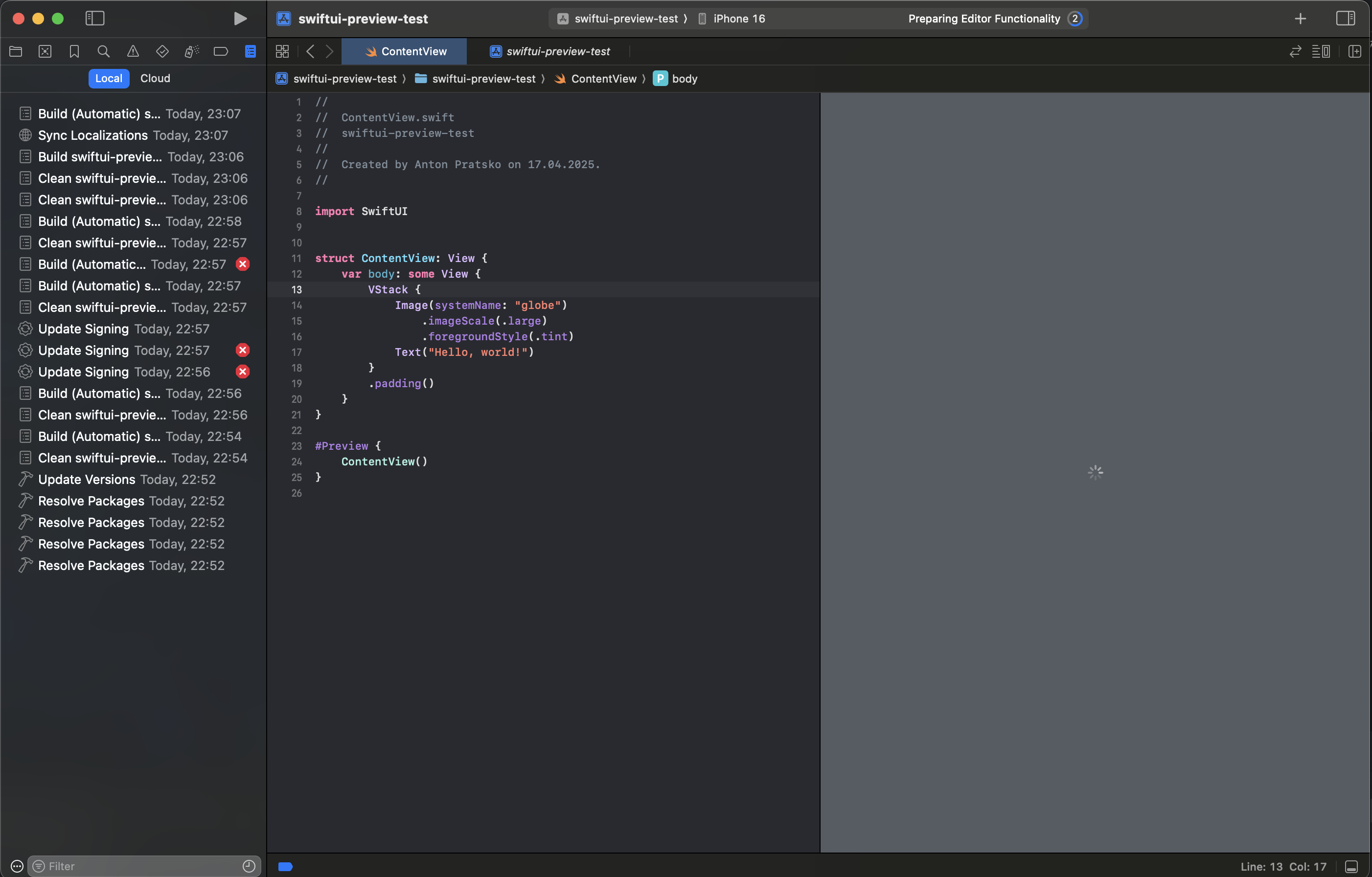

Hi! I develop an iOS library and I met an issue with SwiftUI previews in iOS app project with my library integrated. After I open preview, build for preview finishes successfully, but preview itself never appears. I failed to find any error messages or any other indicators of what went wrong or how to fix it. Switching to legacy preview execution seems to fix problem, but I think that is not ideal. Could you help fixing this?
Xcode 16.2, Simulator iPhone 16, iOS 18.2
Project to reproduce - https://drive.google.com/file/d/1cU6JKwshK_wQfe9YIqcMg3UGWq45OYlx/view?usp=sharing
Preview diagnostics - https://drive.google.com/file/d/1kPcgVSSqreiepGuqhdIoCW2rLSicgsWr/view?usp=sharing

Thanks for posting the diagnostics and screenshot. There's known issues in Xcode 16.2 and iOS 18.2 that we've been working to fix in later builds. Xcode 16.3 is out now and 16.4 beta 1 is also out. If you're able to try out the beta we'd love to know if this has improved for you. But even if you don't want to take that risk, do please update to 16.3.
If you do continue to experience issues please file a feedback with new diagnostics. We've been improving the diagnostics with each Xcode and OS version trying to catch all the interesting quirks that make projects unique.
