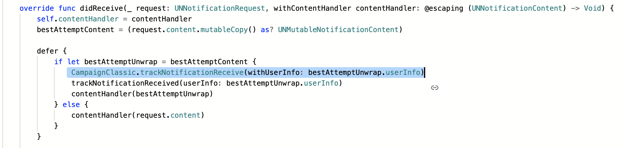

Also in UNNotificationService Extension we are passing the details to Adobe Campaign (as we are using Adobe as our Notification platform), please see the attachment

If the CampaignClassic.trackNotificationReceive is not working you need to debug your app and find out:
  • is it properly configured so the extension is running
  • is the payload correct so the extension is running
  • is the extension crashing
  • is the Adobe library (and anything else you might be using) you are importing to your extension putting it over the 24 MB total memory limit (which will cause the system to terminate your extension)
  • is the CampaignClassic.trackNotificationReceive able to run in an extension and is it able to do it's thing properly. You need to consult with Adobe's support channels to find out if it is not working
  • I see your defer{} block. If your expectation is it will be called under all circumstances, that is not correct. If the extension code is taking longer than 30 seconds, the system will first call serviceExtensionTimeWillExpire() function in your extension. If you don't call the contentHandler() immediately, your extension will be terminated, whether the defer{} block has been executed or not.
  • If you receive serviceExtensionTimeWillExpire() and you are still processing the notification, or pending on CampaignClassic.trackNotificationReceive the notification will be terminated regardless
These are some of the possible things that could be going wrong with the extension that is failing to send the event. You need to debug this issue and find out why.
