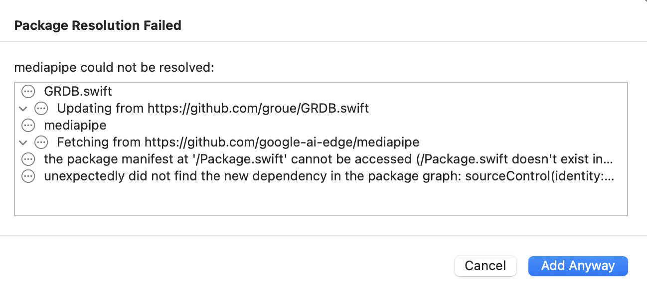

  4. Also, we are open to importing the Mediapipe package on Xcode and building the entire app natively on Swift. Is this something that Apple supports? I tried to add the Mediapipe package but received the below error.

We are getting this error while using mediapipe
Right. The term package is overloaded here. In Xcode, a package means a Swift package. That always has a Package.swift file at the top level. For example, in the GRDB package that’s this file.
When I look at the package that’s failing, I see no indicating that it has any Swift package support.
