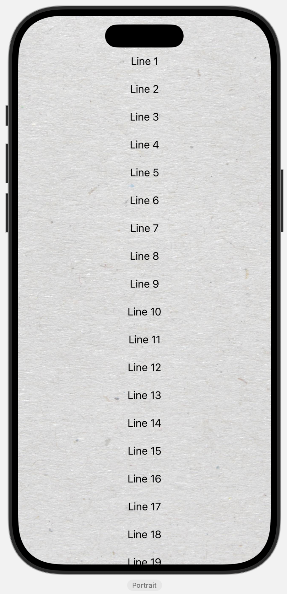

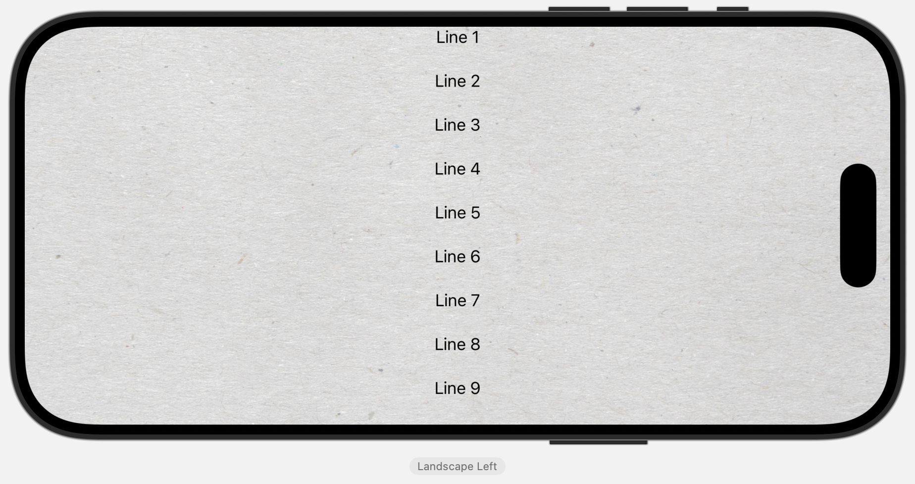

I think you're looking for something like this:
struct ContentView: View {
ScrollView {
VStack(spacing: 24) {
ForEach(1..<20) { i in
Text("Line \(i)")
.frame(maxWidth: .infinity, maxHeight: .infinity)
.background(
Image("background")
.resizable()
.scaledToFill()
.ignoresSafeArea()
#Preview {
ContentView()
The main difference is that my code adds a background to the ScrollView rather than putting everything on top of an image via a ZStack.
When you do it your way, you've kind of told everything on top of that layer how big they'll be, which is why your ScrollView is distorted, and bits of it disappear off the screen.

That doesn't work for me, depending on the background image used.
While my example worked fine with three different images (square, portrait, and landscape images), your new version doesn't work for my landscape image. I get a white area to the right when the Simulator/Preview is in Landscape Left.
