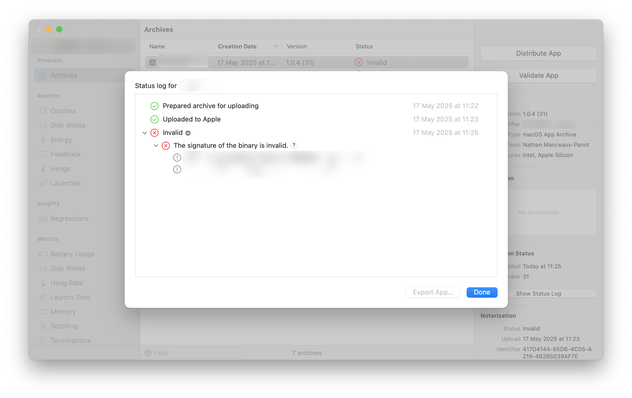

And for good measure, a screenshot of the submission failure in Xcode:
Thank for those UUIDs. I asked the notary team for a copy of those submissions, so I could see exactly what the submitted zip archives look like, and that revealed a clear problem.
