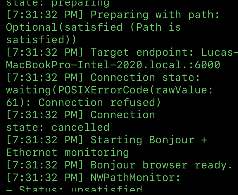

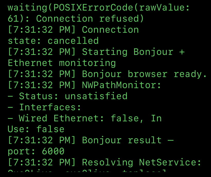

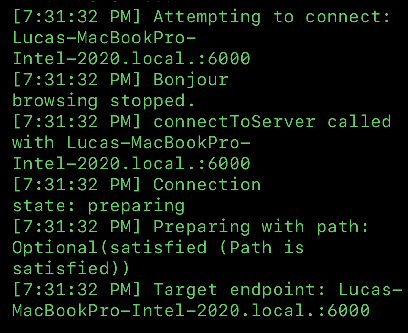

Hi Quinn. Wifi has been off, peer to peer is disabled in the code in a few places. The issue I was having that in my socket connection .preparing state my code
                case .preparing:
                    let path = connection.currentPath
                    DebugLogger.shared.append("Preparing with path: \(String(describing: path))")
                    if let endpoint = path?.remoteEndpoint {
                        DebugLogger.shared.append("Target endpoint: \(endpoint)")
                    if let interfaces = path?.availableInterfaces {
                        var counter = 0
                        for intf in interfaces {
                            DebugLogger.shared.append("🔌 Interface: \(intf.name), type: \(intf.type)")
                            if case intf.type = .wiredEthernet {
                                counter += 1
                        if counter < 0 {
                            self.connection?.cancel()
                    } else {
would produce multiple 'path is satisfied', but no valid wired ethernet interface, and continuously fail until it reached a valid one (en1 on my usb and en5 on my ethernet adapter that goes direct from my MBP to my iPhone).
Interestingly I had my data roaming on as im abroad and having that enabled caused a Bridge100 ipV4 to correctly connect, but I cant rely on that being enabled for an end user, and regardless it doesn't make a difference for my ethernet-only connection.
I've attached some photos of the debugger essentially cycling until en requirement is satisfied. If I try to enforce wired ethernet requirement at the NWMonitor level it simply stalls in a [.cellular] only state. and once again, using a result.endpoint in this same environment (no data roaming, no wifi, no peer to peer etc) it stalls in a .preparing state.
