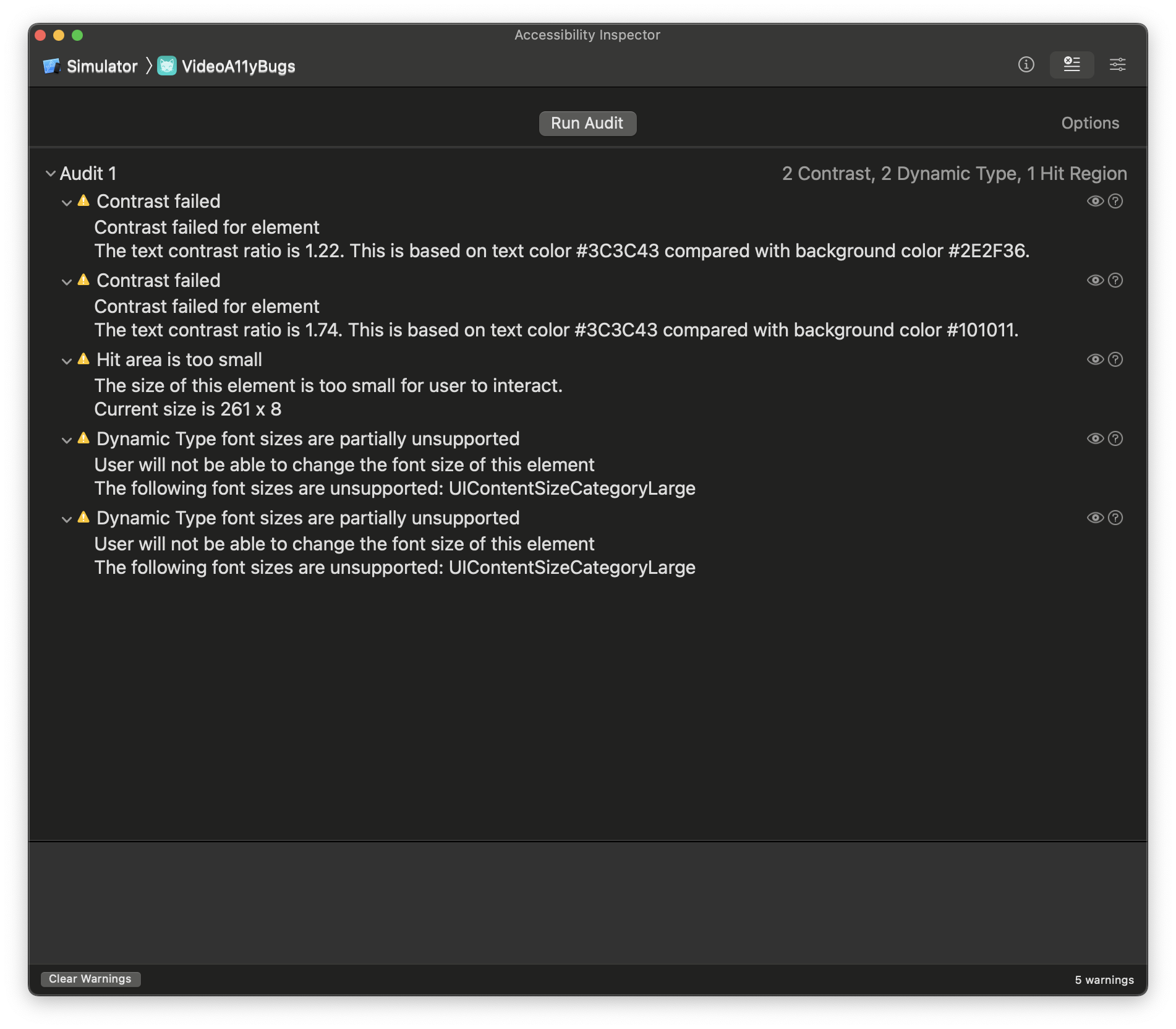

AVPlayer has 3 visual accessibility issues with videos out of the box:
  1. The contrast fails for the current time in the video
  2. The contrast fails for the remaining time in the video
  3. The hit area is too small for the time slider. The WCAG AA requirement is a minimum hit size of 24 x 24. The height of the hit area of the offending region is 8.
Is there a known fix for any of these?

Hello, thank you for highlighting these issues! It would help us greatly if you could file a Feedback Assistant report and attach this sample code. This will allow us to track this issue and report back once it's fixed! Thanks again.
@Engineer Done. FB17348173 (iOS AVPlayer fails accessibility inspector audit out-of-the-box)
