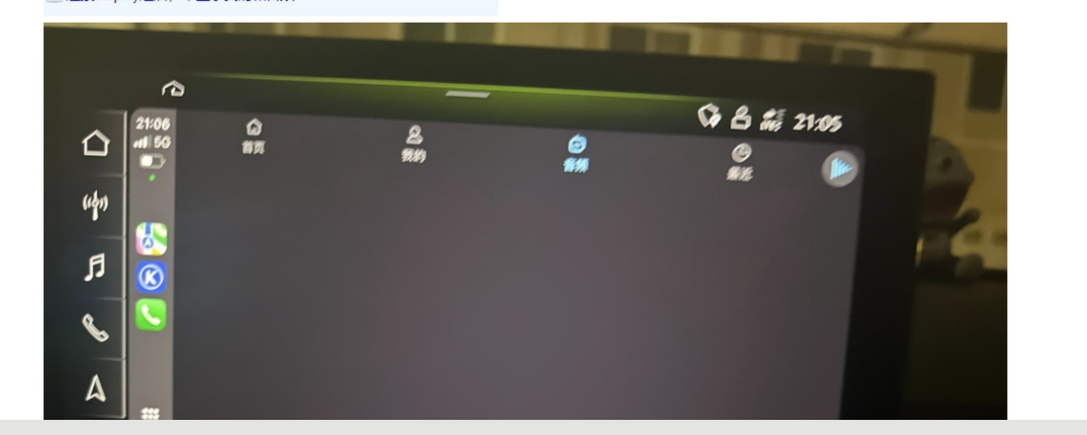

After users upgraded to iOS18.5 beta2, they began to give many feedback on the following issues:
When you switch tab, the interface is blank.

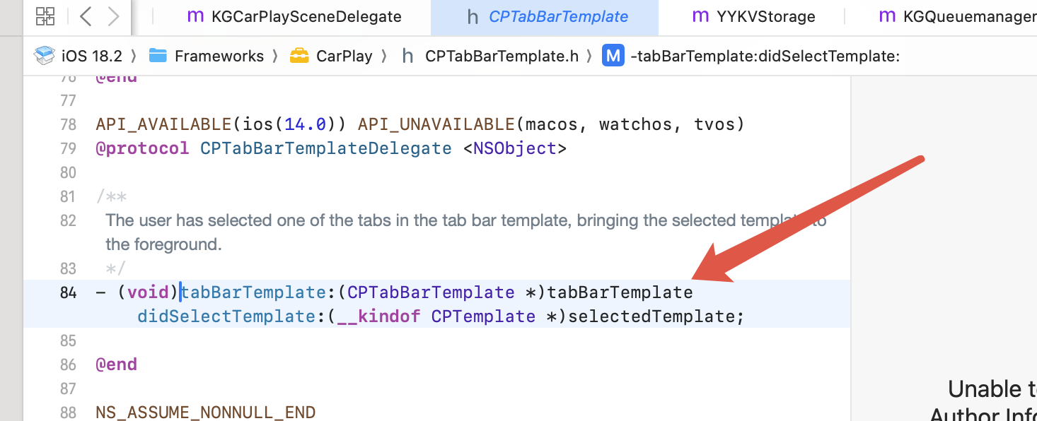

Find out the reason. The method of clicking tab no longer responds. Is this a system bug?

Thanks, we are investigating this on our side.
In the meantime, it is a best practice to populate each tab immediately in the tab bar template, without waiting for the user to select the tab. That way, when the user selects a tab, they do not need to wait for content to load.
