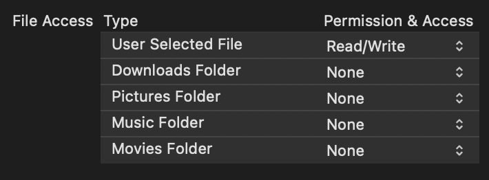

  • Also got it to work by setting App sandbox for any of the user folders: Downloads, Pictures, Music, and Movies to "read only" or "read/write". (see photo). and move the utility to one of them. But this is not where I wanted it to be.
This is not a viable solution. Unfortunately, since you've just posted it on the internet, someone in the future is going to try it and then get frustrated when it gets rejected by App Review.

You're right. it's not a viable solution, but at least it works. After a few frustrating hours of experimentation and Google searches, all failing, the Downloads folder was the thing I tried that finally worked, letting me know it was possible to use a non-system external utility, even if I didn't create it myself.
