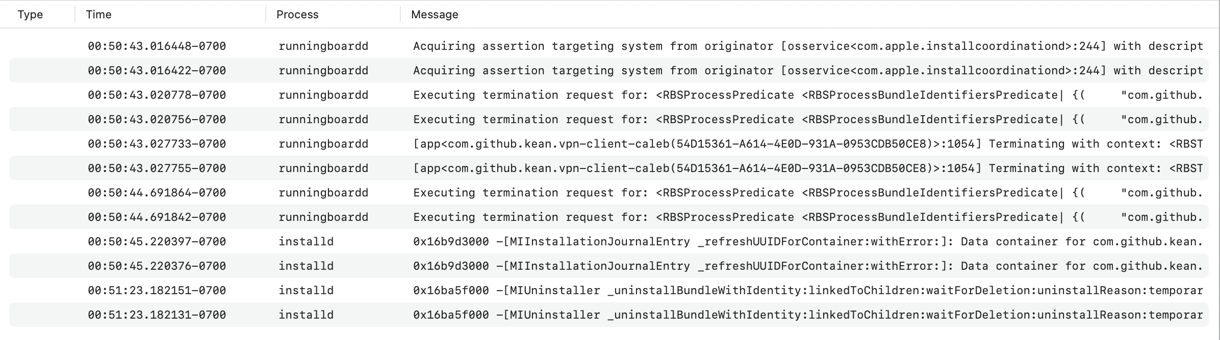

If I pull up the console and filter for the subsystem (com.github.kean.vpn-client-caleb.vpn-tunnel) I see the following.
First you see installd installing it
0x16ba5f000 -[MIUninstaller _uninstallBundleWithIdentity:linkedToChildren:waitForDeletion:uninstallReason:temporaryReference:deleteDataContainers:wasLastReference:error:]: Destroying container com.github.kean.vpn-client-caleb.vpn-tunnel with persona 54D15361-A614-4E0D-931A-0953CDB50CE8 at /private/var/mobile/Containers/Data/PluginKitPlugin/2D0AE485-BB56-4E3E-B59E-48424CD4FD65
And then installd says this (No idea what it means)
0x16b9d3000 -[MIInstallationJournalEntry _refreshUUIDForContainer:withError:]: Data container for com.github.kean.vpn-client-caleb.vpn-tunnel is now at /private/var/mobile/Containers/Data/PluginKitPlugin/2D0AE485-BB56-4E3E-B59E-48424CD4FD65
Concerningly runningboardd seems to immediately try and stop it?
Executing termination request for: <RBSProcessPredicate <RBSProcessBundleIdentifiersPredicate| {(
    "com.github.kean.vpn-client-caleb",
    "com.github.kean.vpn-client-caleb.vpn-tunnel"
[app<com.github.kean.vpn-client-caleb(54D15361-A614-4E0D-931A-0953CDB50CE8)>:1054] Terminating with context: <RBSTerminateContext| explanation:installcoordinationd app:[com.github.kean.vpn-client-caleb/54D15361-A614-4E0D-931A-0953CDB50CE8] uuid:963149FA-F712-460B-9B5C-5CE1C309B2FC isPlaceholder:Y reportType:None maxTerminationResistance:Absolute attrs:[
	<RBSPreventLaunchLimitation| <RBSProcessPredicate <RBSProcessBundleIdentifiersPredicate| {(
)}>> allow:(null)>
Then runningboardd leaves a cryptic message
Acquiring assertion targeting system from originator [osservice<com.apple.installcoordinationd>:244] with description <RBSAssertionDescriptor| "installcoordinationd app:[com.github.kean.vpn-client-caleb/54D15361-A614-4E0D-931A-0953CDB50CE8] uuid:963149FA-F712-460B-9B5C-5CE1C309B2FC isPlaceholder:Y" ID:33-244-5222 target:system attributes:[
)}>> allow:(null)>
And that seems to be all I have to go off of.... If I widen my search a bit I can see backboardd saying things like

I go into the details of your data below, but the basic answer here is that everything you've described here looks like the normal install process. That all happens before you extension would activate, so it doesn't really tell us anything about what's actually going wrong.

Shifting to the log data you sent:
And then installd says this (No idea what it means) _refreshUUIDForContainer:withError
The system uses UUID as the installation "target" for basically "everything" it installs so that it doesn't have to worry about issue like having two apps/components named "MyApp.app" on the same system. Part of that process is that the UUIDs change when an app is updated/installed, which is what _refreshUUIDForContainer actually does.
The system doesn't update apps while they're running, so it has to kill that if it's running. That part of what runningboardd is avoid all the different parts of the system tracking/determining exactly what is or is not running and then sending requests based on that state. What actually happens is that installd basically says "I don't what this app running" and runningboardd will then terminate it if it HAPPENS to be running.
The other thing runningboardd takes care of is here:
In other words, runningboardd isn't just terminating the app (if it happens to be running), it's also make sure nothing else launches it. This is what prevents you from launching apps in the middle of an update.
However, the critical thing to understand here is around this:
runningboardd doesn't really "do" anything. That is, it's job is to do whatever it's told, not to decide what's supposed to happen. That's what this is about:
An "assertion" is the basic structure runningboardd uses for all of the commands it receives. All of those different commands types use this same log format, which is basically:
Who is telling me to do "something" (in this case, "installcoordinationd"):
What I'm being told to do:
)}>> allow:(null)>
Note that understanding this structure can be REALLY helpful when trying to quickly navigate your way through our logs. In this case, I'd actually be looking for the last command that came from any kind of "install" component, as any kind of extension activation isn't going to start until after installation has finished.
