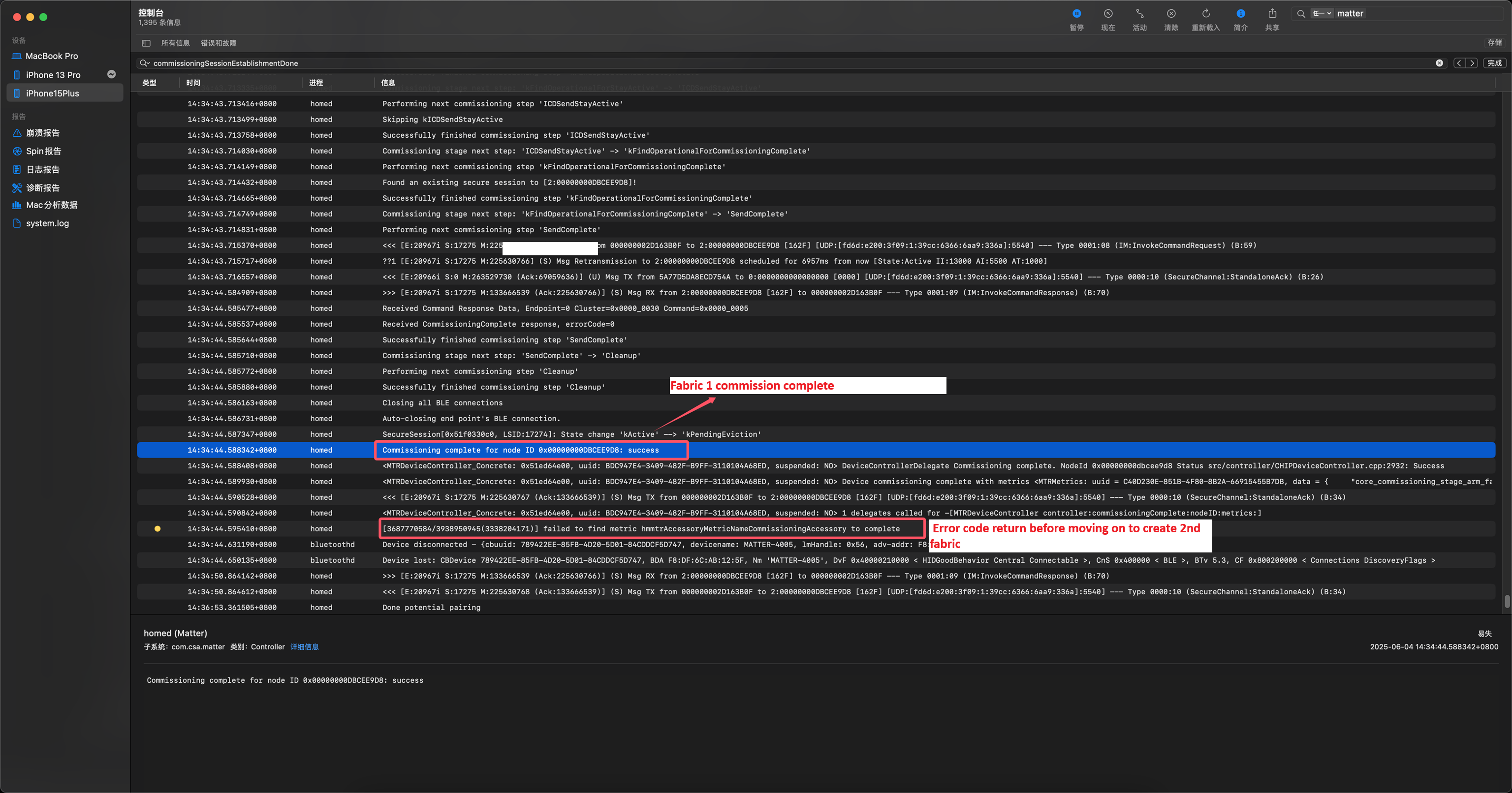

@DTS Engineer sorry that we may have give you the wrong log in the 19/Apr. But the latest log in FB17357284. should be one of the topics is case we that we presenting.
Fabric1 complete (matter thread network created)
默认 2025-04-25 11:14:33.354895 +0800 homed Received Command Response Data, Endpoint=0 Cluster=0x0000_0030 Command=0x0000_0005 默认 2025-04-25 11:14:33.354903 +0800 homed Received CommissioningComplete response, errorCode=0 . . . (Report unable to add device )
错误 2025-04-25 11:14:33.539798 +0800 homed [188914BD-5163-425C-9E59-CAE9BFA1A288] Could not find system commissioner pairing for newly staged server with identifier 6f:d6:63:43:b5:b9 in all pairings: ( "<MTSSystemCommissionerPairing, Uuid: 34355356-AAFA-4604-B
It is only 0.2s between the 2 events, so we suspected that there is some problem with HomeD in the process. Thank you and look forward for your reply
