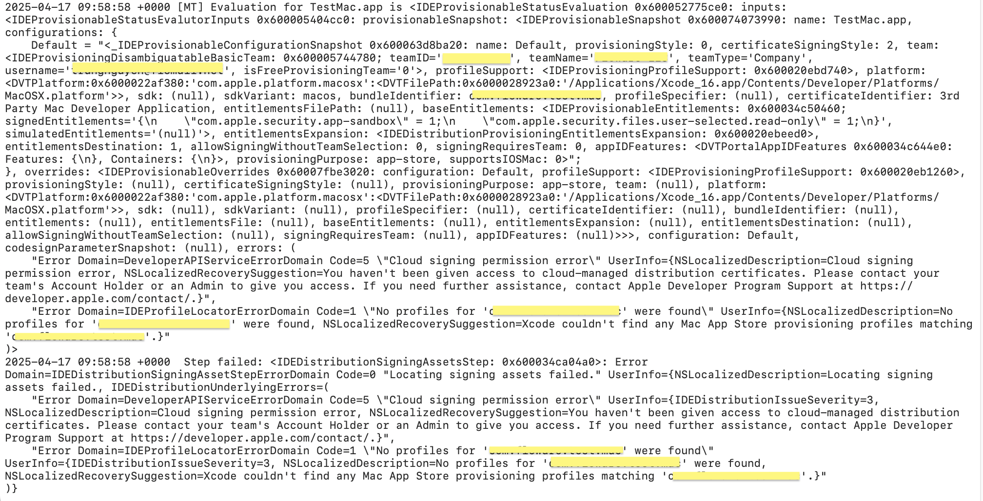

Please see the attached file for the error log from the file "IDEDistribution.verbose.log", and I'm using Xcode 16.0.

Please see the attached file for the error log from the file IDEDistribution.verbose.log
It’s help if you posted logs as text rather than as images. See tip 6 in Quinn’s Top Ten DevForums Tips
Regarding the issue when validate the simple macOS app, the errors have gone if I perform Custom Validate and manually select the AppStore profile.
