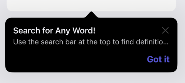

I’m using a custom TipViewStyle to modify the background and slightly adjust the layout of the Tips in my app. Everything looked great until iOS 18.4. Since updating, the layout is being compressed, and the message inside the Tip is getting truncated.
Here’s a screenshot of how it looks on iOS 18.4 (truncated message)
and another showing how it used to look before iOS 18.4 (correct layout).
