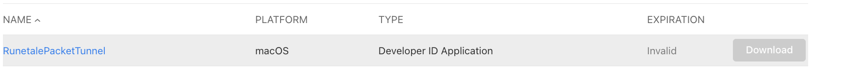

Consecutive posts are not permitted. I noticed something strange. I noticed that a while after creating a provisionprofile used in NetworkExtension, the status was displayed as invalid.
I don't know if the provisionprofile was invalidated, but after installation, when I checked /Applications.Runetale.app, I found that entitlements were not included correctly. The cause seems to be that the priority order of my custom scripts was wrong. Thank you and Apple's engineers for your support.
