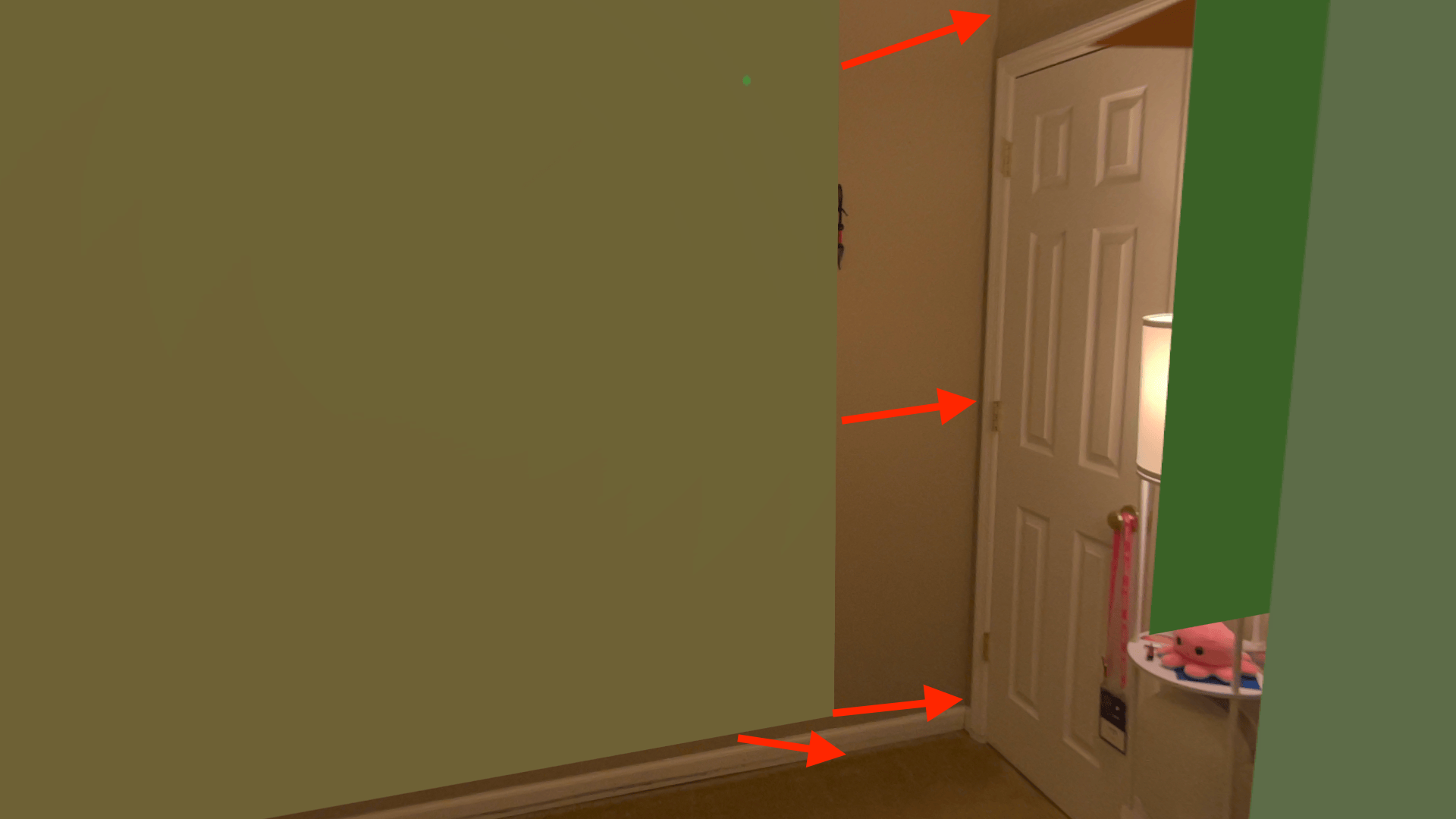

I'm using ARKitSession and PlaneDetectionProvider to detect planes. I have a basics process to create an entity for each detected plane. Each one will get a random color for the material.
Each plane is sized based on the bounds of the anchor provided by ARKit.
let mesh = MeshResource.generatePlane(
  width: anchor.geometry.extent.width,
  depth: anchor.geometry.extent.height
Then I'm using this to position each entity.
entity.transform = Transform(matrix: anchor.originFromAnchorTransform)
This seems to be the right method, but many (not all) planes are not where they should be. The sizes look OK, but the X and Y positions off.
Take this large green plane on the wall. It should span the entire wall, but it is offset along the X position so that it is pushed to the left from where the center of the anchor is.
When I visualize surfaces using the Xcode debugging tools, that tool reports the planes where I'd expect them to be.
Can you see what I'm getting wrong here? Full code below

Answered by PlatformGoblin in 835719022
You can use simple planes if you want but you have to account for the fact that the anchor is not necessarily the center of the plane.
You will still get a "bounding box" style representation and there may be some over/under lap but it should be much closer to what you were expecting.
Something like the following should work for you on both vertical and horizontal planes.
The relevant line is the setTransformationMatrix
entity.setTransformMatrix(
  anchor.originFromAnchorTransform * anchor.geometry.extent.anchorFromExtentTransform,
  relativeTo: nil)

Notes: It appears that the extent is always defined on a vertical plane so if you apply anchorFromExtentTransform you always want to use a vertical plane.
This is rough code from a while ago and I haven't checked to see if there are newer/easier ways to do this.
I think figured out what I was doing wrong. I was using the extents of the anchor to create meshes, then placing the meshes at the transform for the anchor. I was expecting an anchor plane to be something I could turn into a geometric plane.
Diving deeper into it, anchors are not planes the sense that a plane mesh is. These anchors are actually n-gons that don't necessarily line up with shape of a plane. Apple has an example project that creates these, but applies an occlusion material. I swapped that for a material with random colors so I could visualize what is happening. Each anchor has a n-gon, represented with meshVertices. The example project used some extensions to use that data to create shapes for the meshes.
Personally, I found the example project difficult to understand. It has way too much abstraction and stashes the good stuff in extensions.
Here is a modified version of the example from the first post, without the abstractions from the Apple example project.

Hi @radicalappdev
@PlatformGoblin thanks for helping out. I agree, anchorFromExtentTransform is the missing piece of the puzzle. The code to convert a PlaneAnchor to a ModelEntity with collision shapes can be simplified to:
let extent = anchor.geometry.extent
let mesh = MeshResource.generatePlane(width: extent.width, height: extent.height)
let material = SimpleMaterial(color: .green, isMetallic: false)
let entity = ModelEntity(mesh: mesh, materials: [material])
entity.generateCollisionShapes(recursive: false)
entity.transform = Transform(matrix: matrix_multiply(anchor.originFromAnchorTransform, extent.anchorFromExtentTransform))
