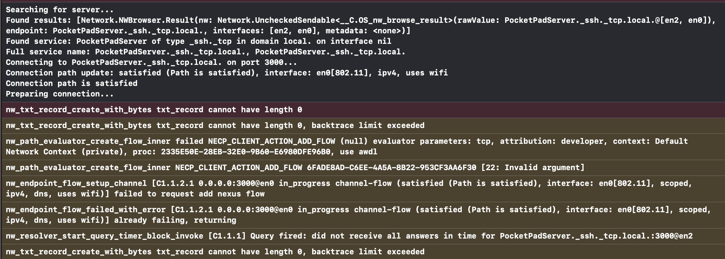

I'm using NWBrowser to search for a server that I hosted. The browser does find my service but when it tries to connect to it, it gets stuck in the preparing phase in NWConnection.stateUpdateHandler. When I hardcode the local IP address of my computer (where the server is hosted) into NWConnection it works perfectly fine and is able to connect.
When it gets stuck in the preparing phase, it gives me the warnings and error messages in the image below. You can also see that the service name is correct and it is found.
I have tried _http._tcp and _ssh._tcp types and neither work.

I am running the client on my iPhone. Also, doing _ssh._tcp was done because _http._tcp hadn't been working and I forgot to change it back to _ssh. I'm not trying to use ssh here. I'm no expert at this networking stuff, am I confused about how these types work?
I can see the server when I run dns-sd -B _http._tcp in the terminal on the same mac.
I read somewhere that I might have to set up two protocols depending on ipv4 and ipv6... Is that something I need to do? Which one would iOS be looking at?
