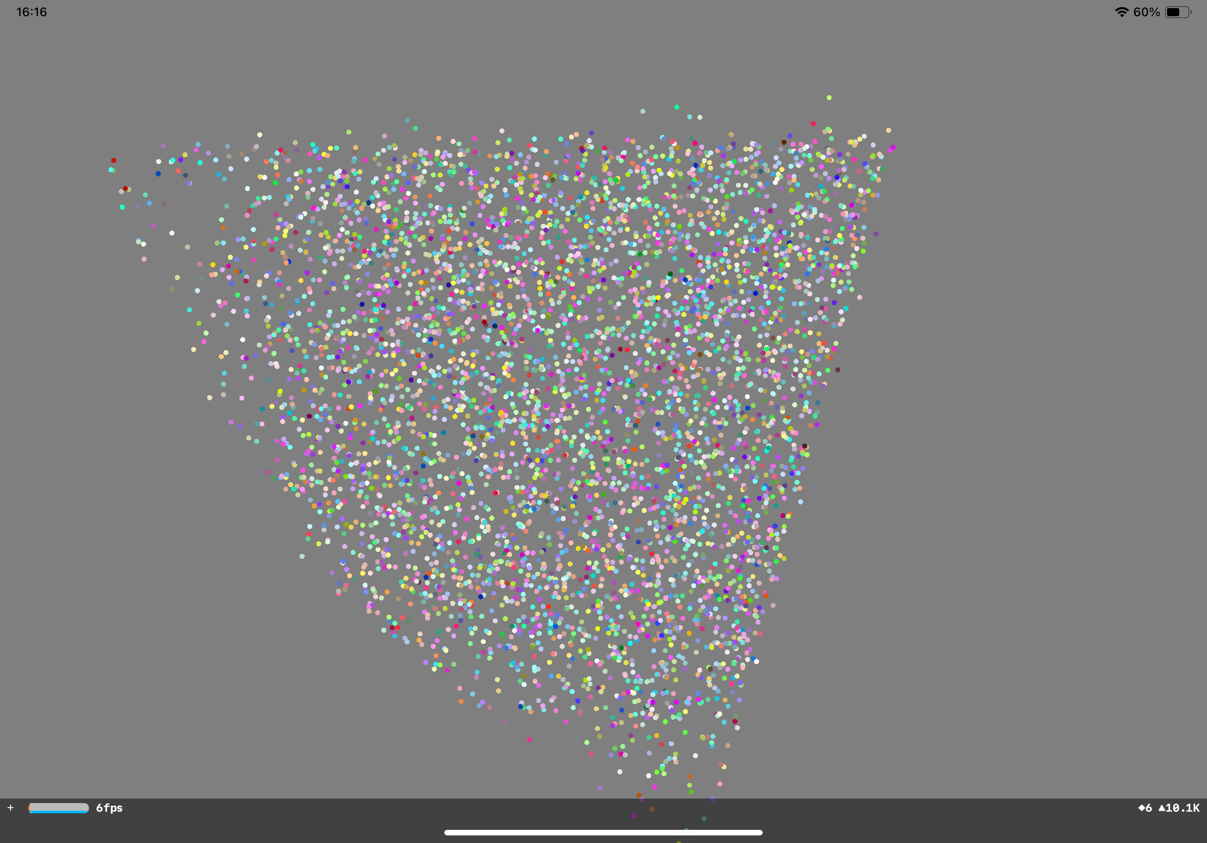

Helo Greg, I have tried setting the pointSize, but that doesn't seem to work Here is my test code:
- (void)viewDidLoad {
    [super viewDidLoad];
    self.sceneView = [[SCNView alloc] initWithFrame:self.view.frame];
    self.sceneView.backgroundColor = [UIColor grayColor];
    SCNScene *scene = [SCNScene new];
    self.sceneView.scene = scene;
    self.sceneView.allowsCameraControl = YES;
    self.sceneView.showsStatistics = YES;
    [self.view addSubview:self.sceneView];
    SCNNode *camNode = [SCNNode node];
    camNode.name = @"cam";
    camNode.camera = [SCNCamera camera];
    camNode.position = SCNVector3Make(0, 0, 100);
    SCNCameraController *camController = [SCNCameraController new];
    camController.pointOfView = camNode;
    camController.target = SCNVector3Zero;
    [self.sceneView.scene.rootNode addChildNode:camNode];
    self.sceneView.pointOfView = camNode;
    // test cloud point
    NSInteger count = 10000;
    NSMutableData *vertexData = [NSMutableData data];
    NSMutableData *colorData = [NSMutableData data];
    for (int i = 0; i < count; ++i) {
        float x = (float)(arc4random() % 20001) / 100.0f - 100.0f;
        float y = (float)(arc4random() % 20001) / 100.0f - 100.0f;
        float z = (float)(arc4random() % 20001) / 100.0f - 100.0f;
        SCNVector3 point = SCNVector3Make(x / 2, y / 2, z / 2);
        [vertexData appendBytes:&point length:sizeof(SCNVector3)];
        float r = (float)(arc4random() % 255) / 255.0f;
        float g = (float)(arc4random() % 255) / 255.0f;
        float b = (float)(arc4random() % 255) / 255.0f;
        [colorData appendBytes:&r length:sizeof(float)];
        [colorData appendBytes:&g length:sizeof(float)];
        [colorData appendBytes:&b length:sizeof(float)];
    SCNGeometrySource *vertexSource = [SCNGeometrySource geometrySourceWithData:vertexData
                                                                       semantic:SCNGeometrySourceSemanticVertex
                                                                    vectorCount:count
                                                                floatComponents:YES
                                                            componentsPerVector:3
                                                              bytesPerComponent:sizeof(float)
                                                                     dataOffset:0
                                                                     dataStride:sizeof(SCNVector3)];
    SCNGeometrySource *colorSource = [SCNGeometrySource geometrySourceWithData:colorData
                                                                      semantic:SCNGeometrySourceSemanticColor
                                                                   vectorCount:count
                                                               floatComponents:YES
                                                                    dataOffset:0
    SCNGeometryElement *element = [SCNGeometryElement geometryElementWithData:nil
                                                                primitiveType:SCNGeometryPrimitiveTypePoint
                                                               primitiveCount:count
                                                                bytesPerIndex:sizeof(int)];
    element.pointSize = 10; // set a value, But it doesn't seem to work
    element.minimumPointScreenSpaceRadius = 1.0;
    element.maximumPointScreenSpaceRadius = 10.0;
    SCNGeometry *geometry = [SCNGeometry geometryWithSources:@[vertexSource, colorSource] elements:@[element]];
    SCNNode *node = [SCNNode nodeWithGeometry:geometry];
    [self.sceneView.scene.rootNode addChildNode:node];
