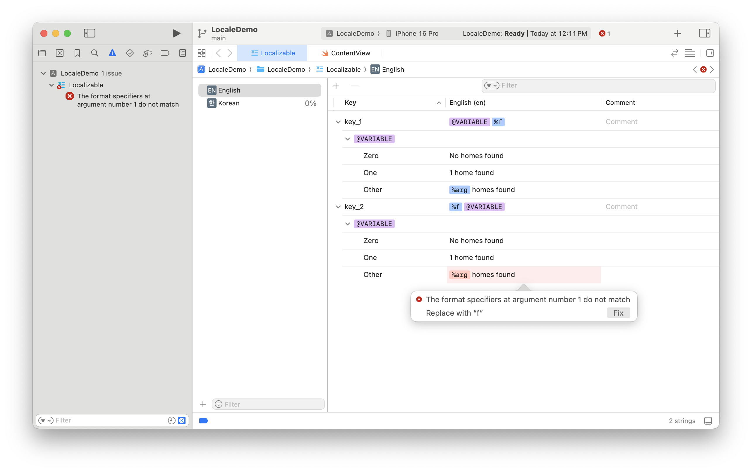

It seems that Xcode gets confused when there is another format specifier before a plural variable.
As shown in the screenshot, %#@VARIABLE@ %f
works fine, but an error occurs with %f %#@VARIABLE@
This is likely because VARIABLE
is associated with argument number 1 rather than argument 2, which would mean %arg
also represents argument number 1 and is currently contradicting %f
. In this case, the error is pointing out a legitimate problem with the string that will have runtime impact.
