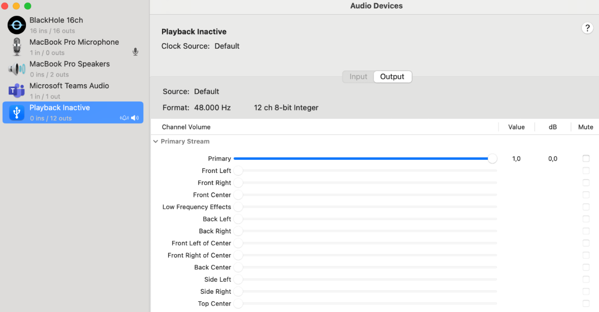

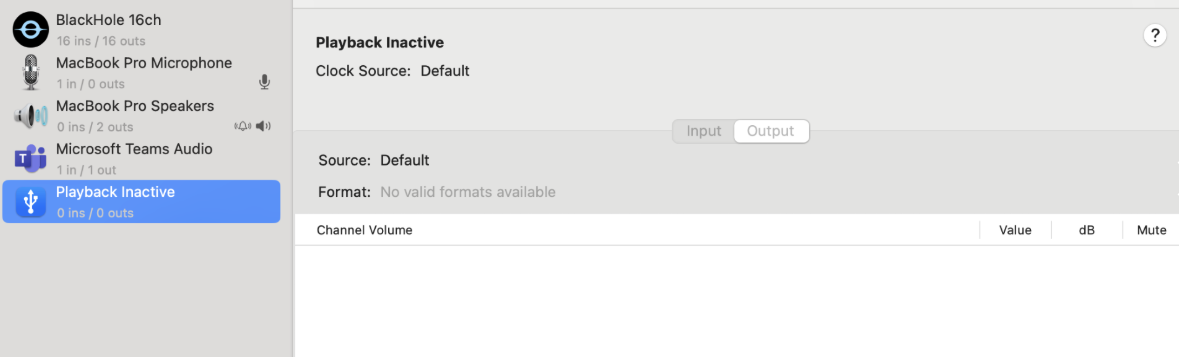

I have a custom USB Audio Class 2 (UAC2) compatible device. When I connect this custom device to a MacBook with a configuration of up to 10 channels (16-bit), everything seems to work fine. However, when I increase the channel count to 12, the MacBook does not recognize the 12 channels. It only shows the channel count as 0.

Could you let me know the current limitations of the Audio Class Drivers on the latest macOS versions? What configuration should I use to get 12 channels working?
P.S. I also found that a 12-channel, 8-bit configuration is detected by the MacBook, bit I want it to work with 16bits.

Here's the descriptor of alternate interface 1 of interface 3, the audio streaming interface, when set to 12 channels of 8-bit-per-sample audio:

By the way, I checked the usbdiagnose output for 8bit (working condition) and 16bit configs. The only noticeable difference is the Max Packet Size which is 558 (8bit case) and 1024 and 1023 (16bit case). I am not sure why it shows two values in two different places. I have attached the output as files for your reference.
On the log collect --last 1m the only meaning full error was from coreaudiod
HALS_PlugIn.cpp:834   HALS_PlugIn::HostInterface_PropertiesChanged: the object is not valid
