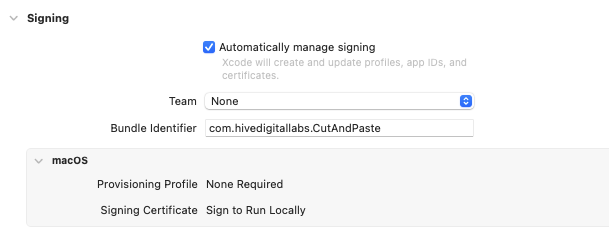

Hi all, I'm developing a simple Finder Sync Extension, using Xcode 16.3. When running in Debug with Xcode, everything works fine. Instead, when compiling in Release and launching the containing app (by double-clicking on it), the Extension is not recognized (neither loaded) by the system.
The only difference between Debug and Release stands in Signing configuration:
Debug:

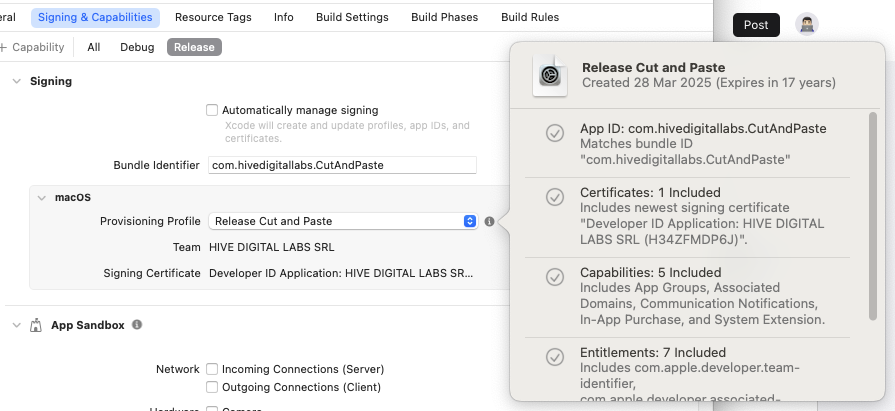

Release:
As you can see, in Release I'm using a Provisiong Profile, configured with my company's Developer ID. I'm wondering if Capabilities and Entitlements are not what is needed by my app. Anyway, I have no idea what the issue is.
