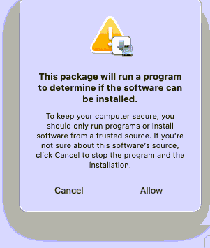

Warning During Installation: While installing the .pkg file, a security warning appears as follows. Please help us to resolve this.

Hello @rakesh_selvam, thank you for confirming. Since you are able to notarize your installer and the alert is a consequence of the installer plug-in, it seems things are working correctly.
Your spctl command returns "rejected" because --assess defaults to --type=execute, and you need to write --type=install.
Your installer probably includes a pre-install script. If you didn't have one, you wouldn't see the warning during installation.
Thanks for opening a forums thread about this.
First up, this has nothing to do with notarisation. No amount of better code signing or notarisation will address this issue. Rather, this alert is due to the way that you’re installer package is constructed.
I’m not an installer expert but I believe this is caused by your installer package using the allow-external-scripts property. Quoting the the docs:
Specifies whether the run and runOnce JavaScript functions can be executed.
That, in turn, leads to:
And it’s that capability that’s triggering this alert. Indeed, it’s actually documented as such:
the Installer application asks the user’s permission before launching the program
If you don’t want that alert, you’ll have to rework your installer package to avoid this facility.

Hello @rakesh_selvam, thank you for sharing your distribution manifest. I don't see allow-external-scripts being used. Besides this flag, the Installer app can still prompt the user with "This package will run a program to determine if the software can be installed" if your installer has plug-ins. Are you including any plug-ins?
@Engineer Yes, we have included OpenJDK as a plugin. I would like to inform you that the OpenJDK files are code-signed prior to notarization.
Hello @rakesh_selvam, thank you for confirming. So the alert you are seeing is a natural consequence of adding a plug-in. Since plug-ins are loadable bundles, the Installer app requires an additional confirmation step from the user.

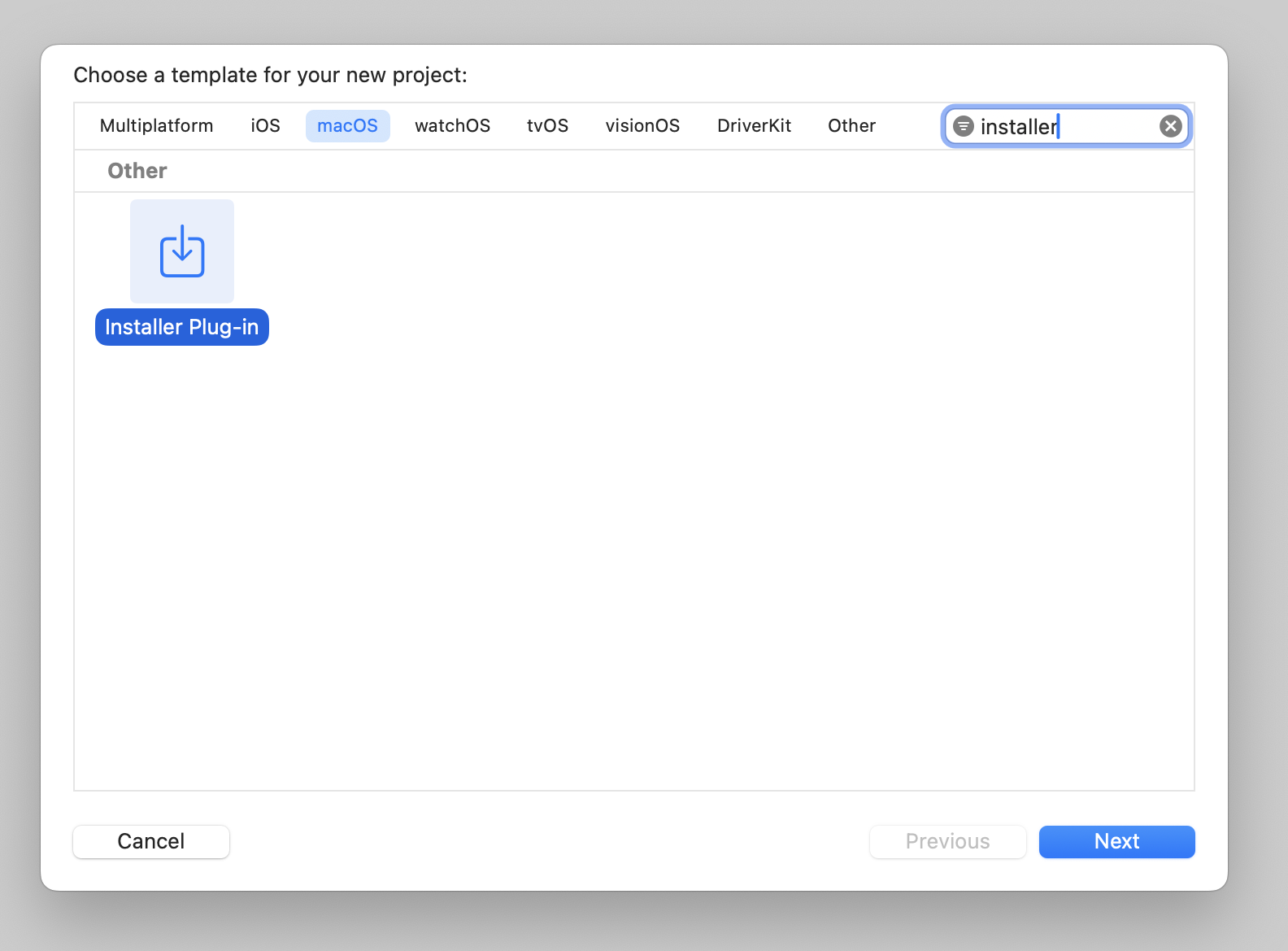

Hello @rakesh_selvam, just to clarify, when I say installer plug-in, I mean a bundle created in Xcode to present a custom installation step to the user:
It seems OpenJDK might not be the same thing. Besides OpenJDK, are you including a custom installation step that could be causing the alert?
@Engineer Thank you for the clarification. Yes, we are using our own plugin to present a custom installation step.
