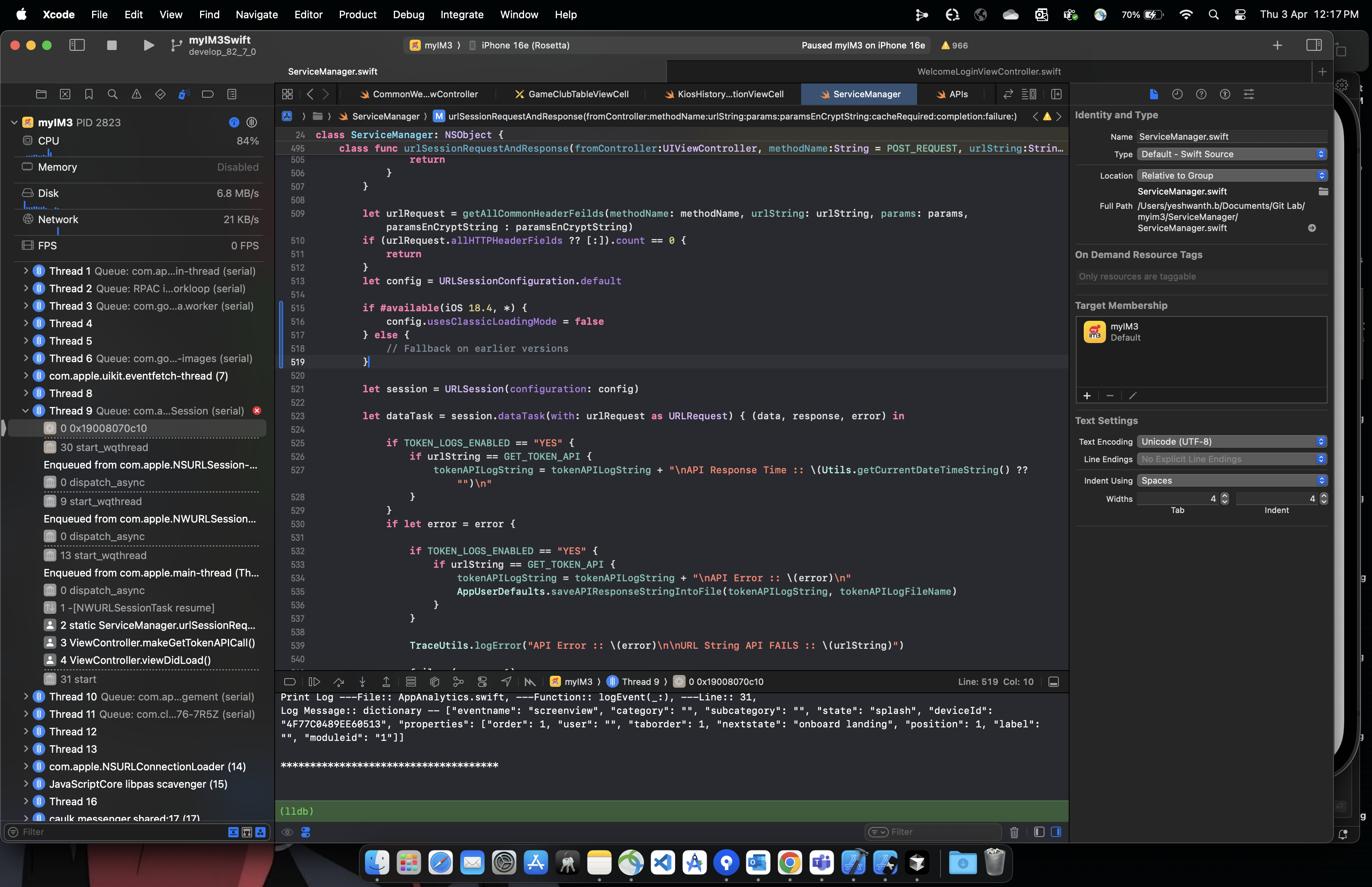

please check the screenshot
find the crash details below :
*** Terminating app due to uncaught exception 'NSInvalidArgumentException', reason: '-[__NSCFBoolean objectForKeyedSubscript:]: unrecognized selector sent to instance 0x1f655c390' *** First throw call stack: (0x188ae52ec 0x185f69a7c 0x188b4f67c 0x1889fcb84 0x1889fc4f0 0x191393bc8 0x1889ec8a0 0x1889ec6e4 0x191393ad0 0x191344dac 0x191344b58 0x107cfa064 0x107ce36d0 0x191343fcc 0x1891b3b18 0x1892dae58 0x189235c60 0x18921e270 0x18921d77c 0x18921a8ac 0x107ce0584 0x107cfa064 0x107ce891c 0x107ce95d8 0x107ceabcc 0x107cf5894 0x107cf4eb0 0x212f51660 0x212f4e9f8) terminating due to uncaught exception of type NSException
I’m sorry but what you posted doesn’t help. Your first follow-up post is a screen shot and your second is just a repeat of stuff that you put in your original question. I need a crash report. Posting a Crash Report has lots of info on how to get that.
If you post a crash report, I should be able to offer further advice.

NSExceptionDomains dictionary‘s keys are domains. They are individual domain overrides for ATS. NSExceptionAllowsInsecureHTTPLoads and NSIncludesSubdomains are in a nested dictionary of the specific domain.
URLSessionConfiguration to set usesClassicLoadingMode as false
