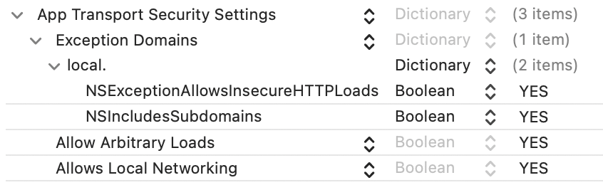

We believe we have configured ATS properly (App Store version):

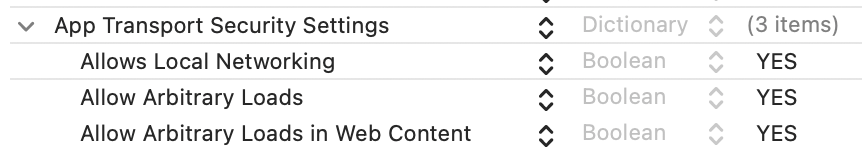

In panic we have also tried this in Test Flight version:
The latter actually seemed to make a difference when running the app on macOS Apple Silicon. But on iOS it didn't seem to make any difference.

Do we configure ATS correctly for this scenario?
No. You should only need NSAllowsLocalNetworking.
I’ll note that, if ATS were blocking this request, it would fail promptly and with a helpful log message. Given the symptoms you’ve described, I very much doubt this is an ATS issue.

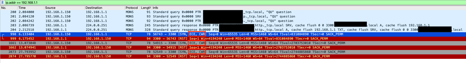

Beyond that, what I’d do next is to look at what’s happening on the ‘wire’. It’s quite possible that the device is sending a request but your accessory is not responding. Use an RVI packet trace for this.
That’ll also let you compare the iOS 17 and 18 behaviour.

By using the rvictl tool as you suggested we were able to see a difference between iOS 17/18!
In iOS 18 the SYN message has also the ECE and CWR flags set! Our device responds with RST and then iOS 18 tries two more times with same result:
Isn't iOS 18 supposed to fallback on RST and send new SYN without those flags set?
If not then what are the alternatives?
  • Can we configure this for our app? We use NSMutableURLRequest.
  • Do we need to update some really old firmware in our device? This is most likely not possible and will make some customers sad :(
I don’t know enough about that part of TCP to offer an opinion on this. Fortunately, my opinion doesn’t actually matter (-: If you think this should change, you should file a bug and our TCP experts will take a look.
Fix your accessory, obviously (-:
You won’t be able to workaround this at the URLSession level. It simply doesn’t give you control over low-level details like this.
You might be able to work around this by dropping down to Network framework. It has a disableECN option that you can set.
Of course, the drawback here is that you have to implement HTTP on top of Network framework. If your HTTP requirements are really simple, you could tackle that directly. If not, see the advice in the HTTP alternatives section of TN3151 Choosing the right networking API.
I recommend that you prototype this before going too far. That is, use NWConnection to open a TCP connection your accessory with disableECN set. If that avoids the RST, you can then decide how you want to handle HTTP.

@DTS Engineer , I don't assume that we have correctly identified the problem,
But to us it seems like a failed negotiation for TCP SYN, i.e., Apple network framework not doing fallback to a basic TCP SYN.
