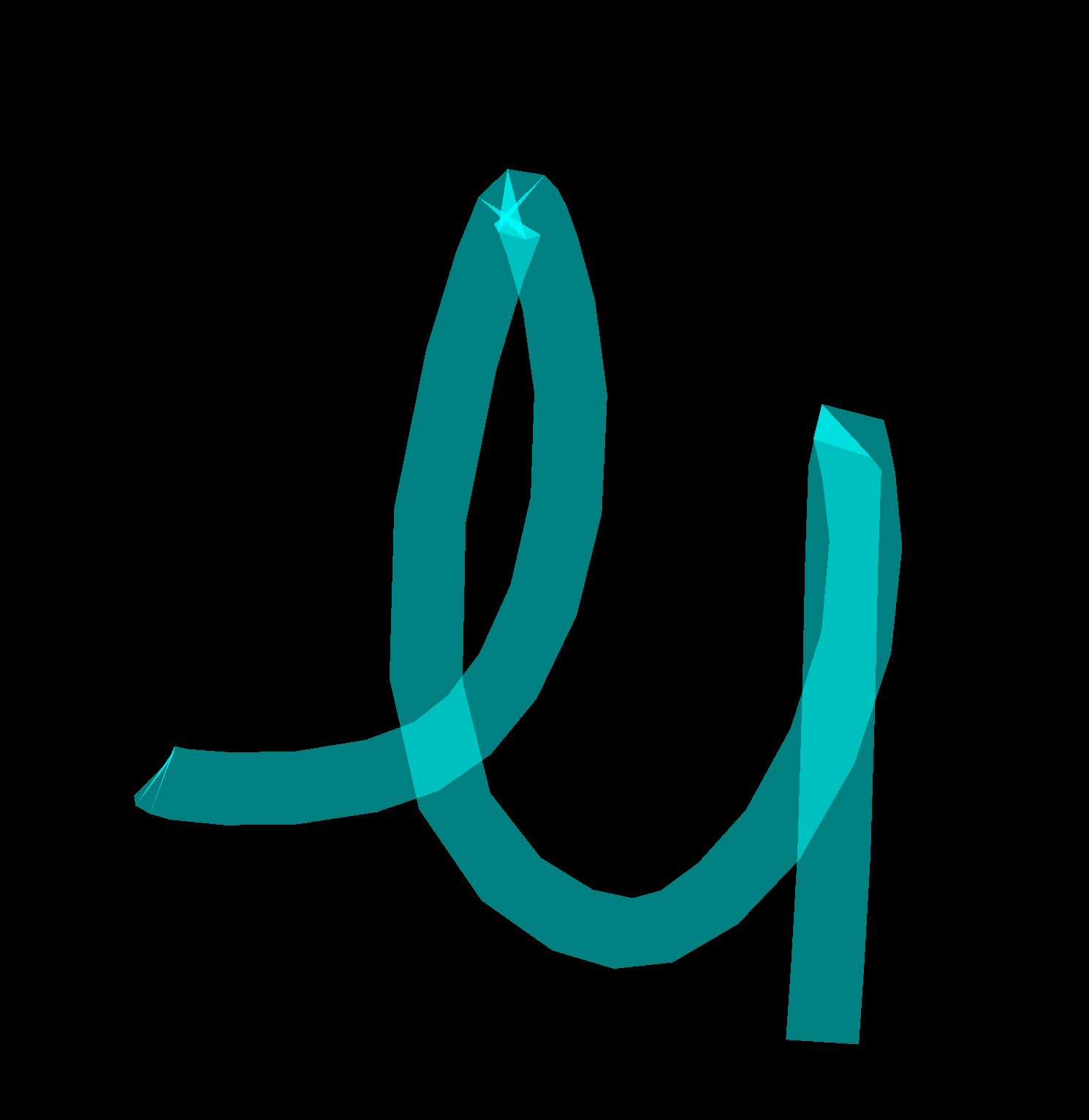

I’m running into this issue trying to create a uniform opacity per path. I have a solution but do not love it - as this is a realtime app and the solution could have some bottlenecks. If I just generate a triangle strip from touch points and do my best to smooth, resample, and handle miters I will always get some overlaps. See:

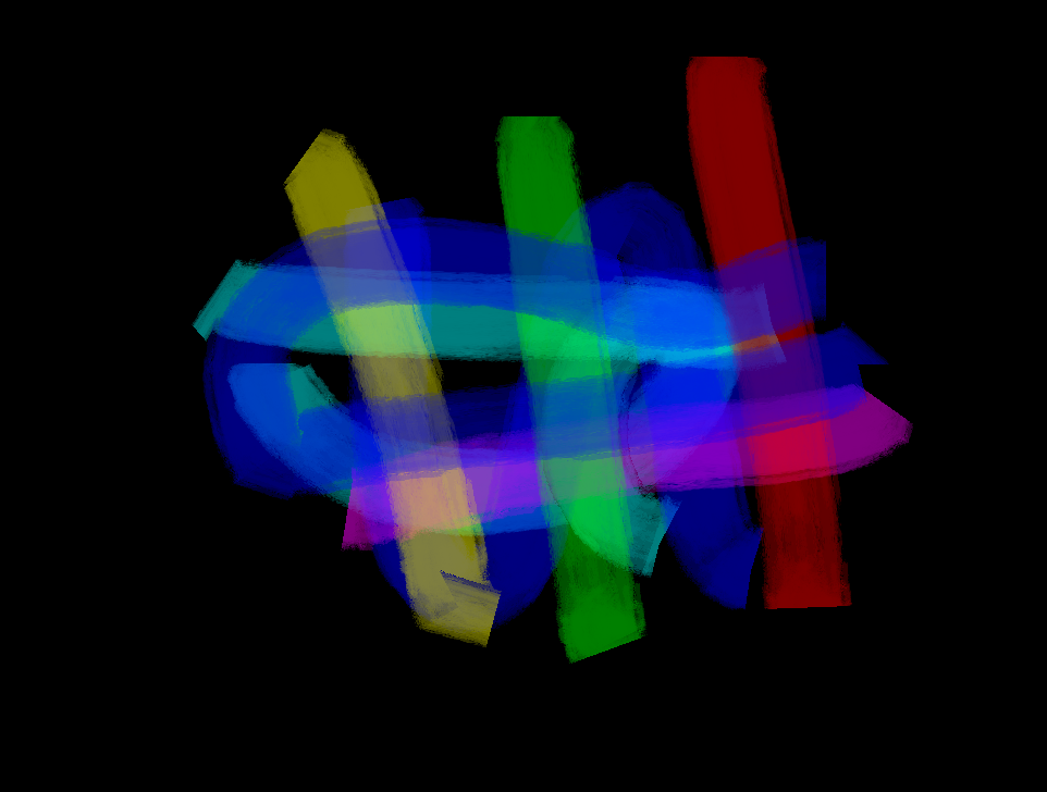

To create a uniform opacity I render to an offscreen texture with blending disabled. I then pre-multiply the color and draw that texture to a composite texture with blending on (I do this per path). This works but gets tricky when you introduce a textured brush, the edges of the texture in the frag shader cut out the line. Pasted Graphic 1.png Solution: I discard below a threshold
fragment float4 fragment_line(VertexOut in [[stage_in]],
                              texture2d<float> texture [[ texture(0) ]]) {
    constexpr sampler s(coord::normalized, address::mirrored_repeat, filter::linear);
    float2 texCoord = in.texCoord;
    float4 texColor = texture.sample(s, texCoord);
    if (texColor.a < 0.01) discard_fragment(); // may be slow (from what I read)
    return in.color * texColor;
Better but still not perfect.
Question: I'm looking for better ways to create a uniform opacity per path. I tried .max blending but that will cause no blending of other paths. Any tips, ideas, much appreciated. If this is too detailed of a question just achieve.
Looking at your first image, the traditional GPU solution would be to use the stencil buffer to only paint each pixel once.
If you have anti-aliased edges, the binary stencil buffer isn't perfect. But you can use the alpha channel in the framebuffer to get a similar but fractional effect.
Or you can re-triangulate your triangle strips on the CPU to get a geometry that doesn't self-intersect. You should aim to do that ahead-of-time, but it's not completely impossible to do it for every frame.
In your other images with the brush texture, I think that again using the framebuffer alpha as a pseudo-stencil is probably the best solution.
