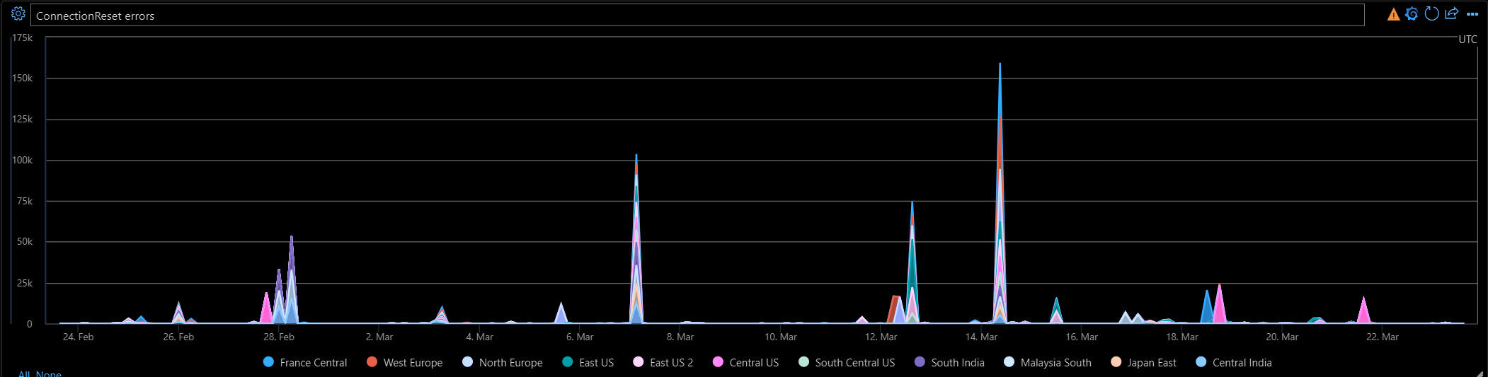

We are experiencing strange and short error spikes towards APNS that seem to mostly correlate worldwide. We checked the networking and push request code but could not find what could be causing this. These error spikes are all timeouts or connection resets (by remote host, ie. APNS servers) and seem to come and go randomly:
Would it be possible to check this for outages or some other metrics on your side or investigate why would it happen? Since it's worldwide it seems unlikely it's something broken on our side. We are using the standard APNS http2 endpoint with modern support for all RFC features (so everything should work normally).
Mind you, our api might be in a unique position because of the volume of notifications (in the billions per day).

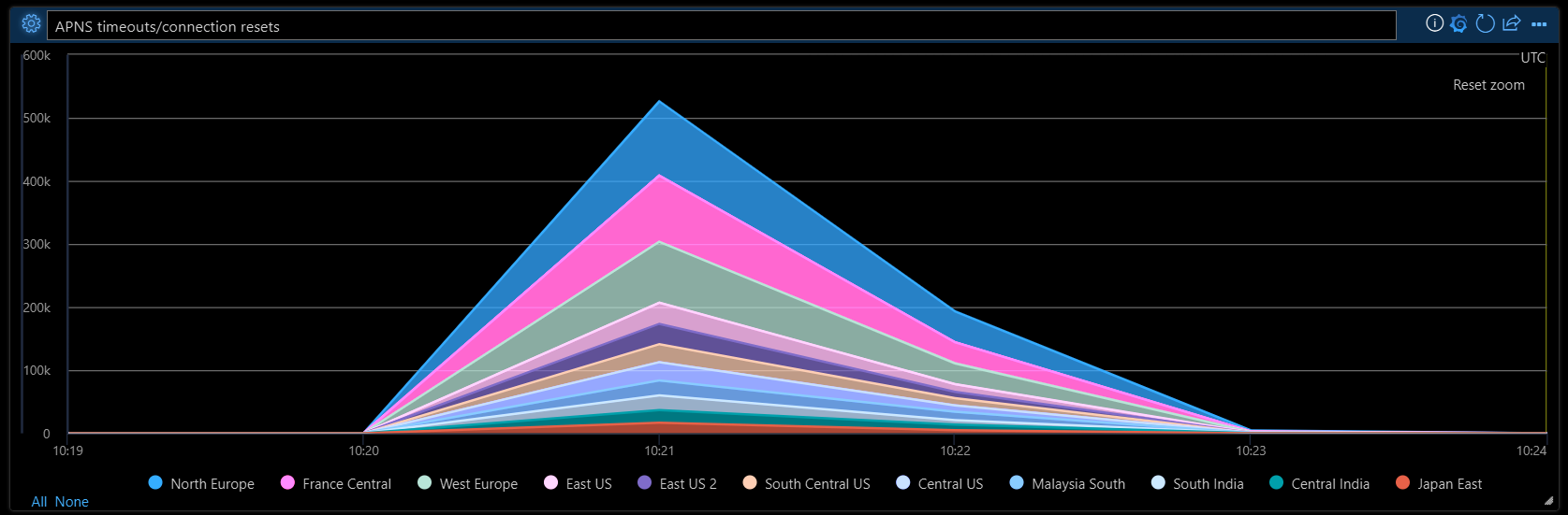

Well the issue is happening in vastly different parts of the world, with independent networking and hardware. Some areas are off-peak and some are peak hours, despite this the issue seems extremely coordinated every time (down to a specific minute).
For example large incident was on 14th March around 10:21 UTC:
