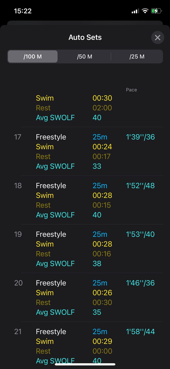

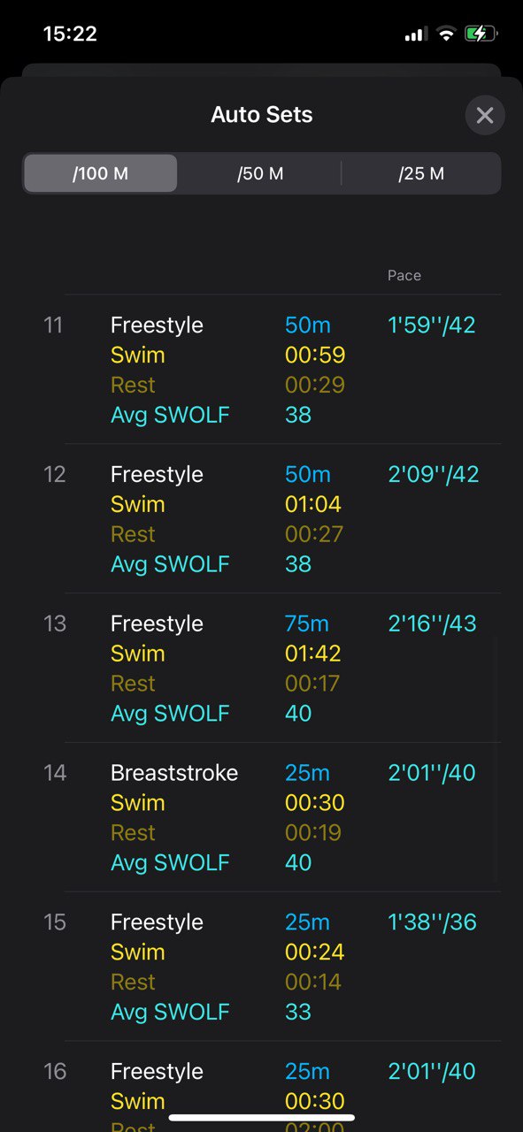

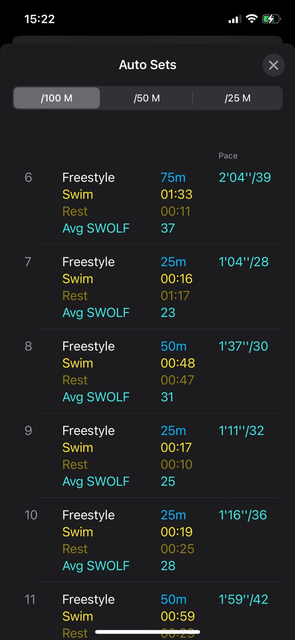

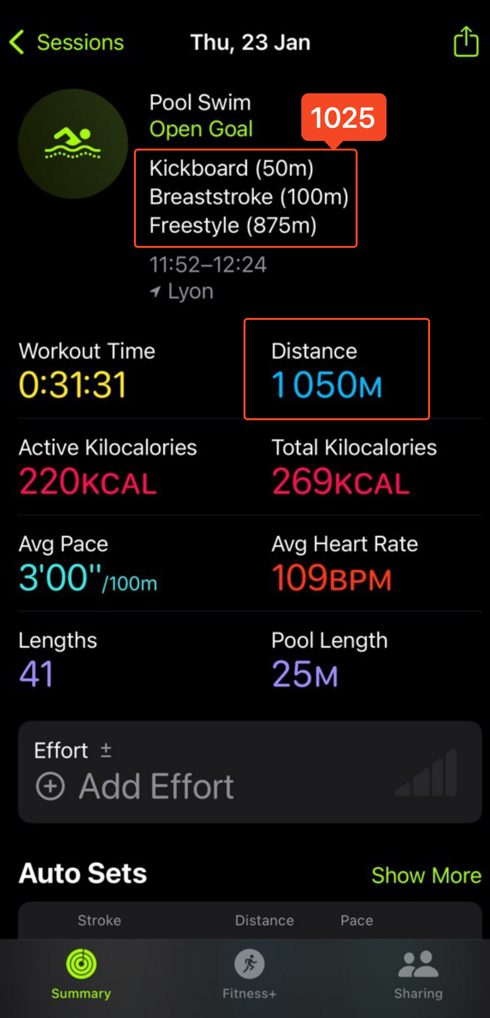

We have 2 issues on our side.
1. We struggle with distances in Fitness app.
As we can see with this activity (a real activity), when we compare Total Distance with the Sum of All Sets, both distances are different.
Total Distance = 1050 m
Sum of All Sets = 1025 m
There are 25 m difference between total values and set details.
2. Then, on our side, we have 2 options to calculate swimming distance but we don’t know which one is the best to use.
a Option 1 : pool length * number of laps = swimming distance
With this option, we see that distance is matching total distance from Fitness app. But for some activities (are shown above), some distance per set (segment) are different than from Fitness app.
b Option 2 : Fetch all distances values via HKQuantityTypeIdentifier.distanceSwimming (HKSampleQuery) .
With this option, we see that distance is matching sum of all sets distance from Fitness app. But for some activities (are shown above), total distance is different than from Fitness app.
Also we added more screenshots from the Fitness app and raw data from that workout sesseion.
Thanks for providing the screenshots, which are quite helpful.
Your screenshots show the data per set. From there, I calculated the total of each activity and got the following:
  • Kick-board: 50
  • Breaststroke: 75
  • Freestyle: 925
This is different from the data shown in Fitness.app, which is:
  • Kick-board: 50
  • Breaststroke: 100
  • Freestyle: 875
This inconsistency is probably because Fitness.app does something wrong, and so I'd suggest that you file a feedback report with all the information, and share your report ID here. I can probably use your report to see what the HealthKit folks have to say.
The total of all activities from the per-set data, which is 1050, is the same as the Distance in Fitness.app.
