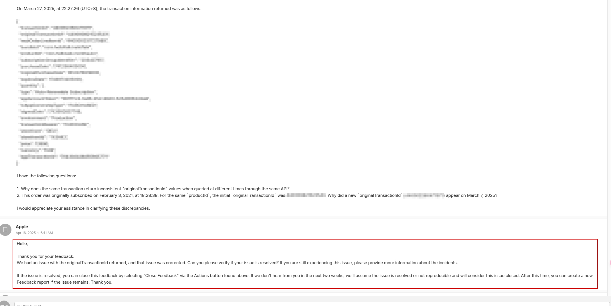

@DTS Engineer I am a colleague of TaroHongo. I raised report here. FB17110094
Thanks.
What's the difference between replying and not replying? You don't talk about the cause, you don't talk about how to solved it ? And also the problem is still happening...
