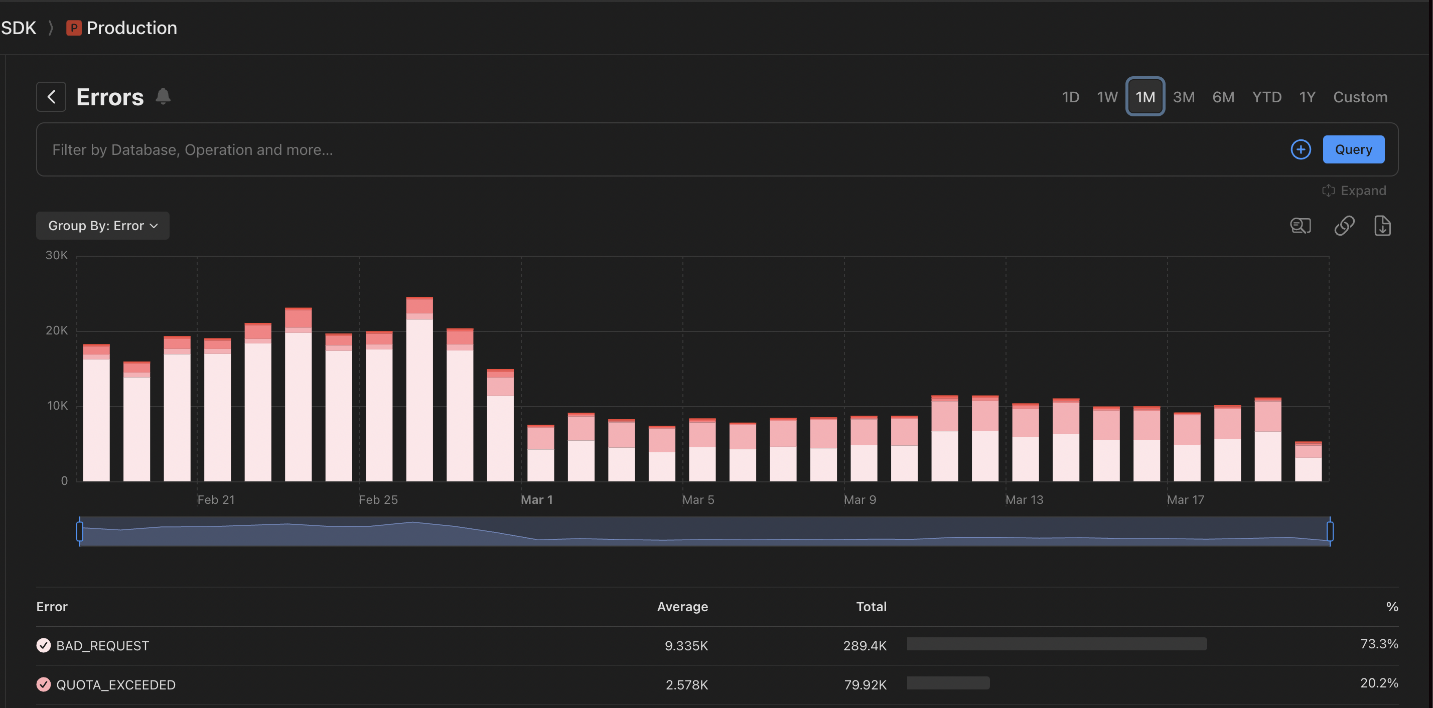

"BAD_REQUEST" in iCloudKit Telemetry
I've recently added iCloud backup on my chat app. Conversations are backing up fine but some users are losing their chats and when I see the telemetry it show "BAD_REQUEST" error. I couldn't find any details or solution for it. Does anyone has any idea what it could be? My development scheme is already fully deployed to production.

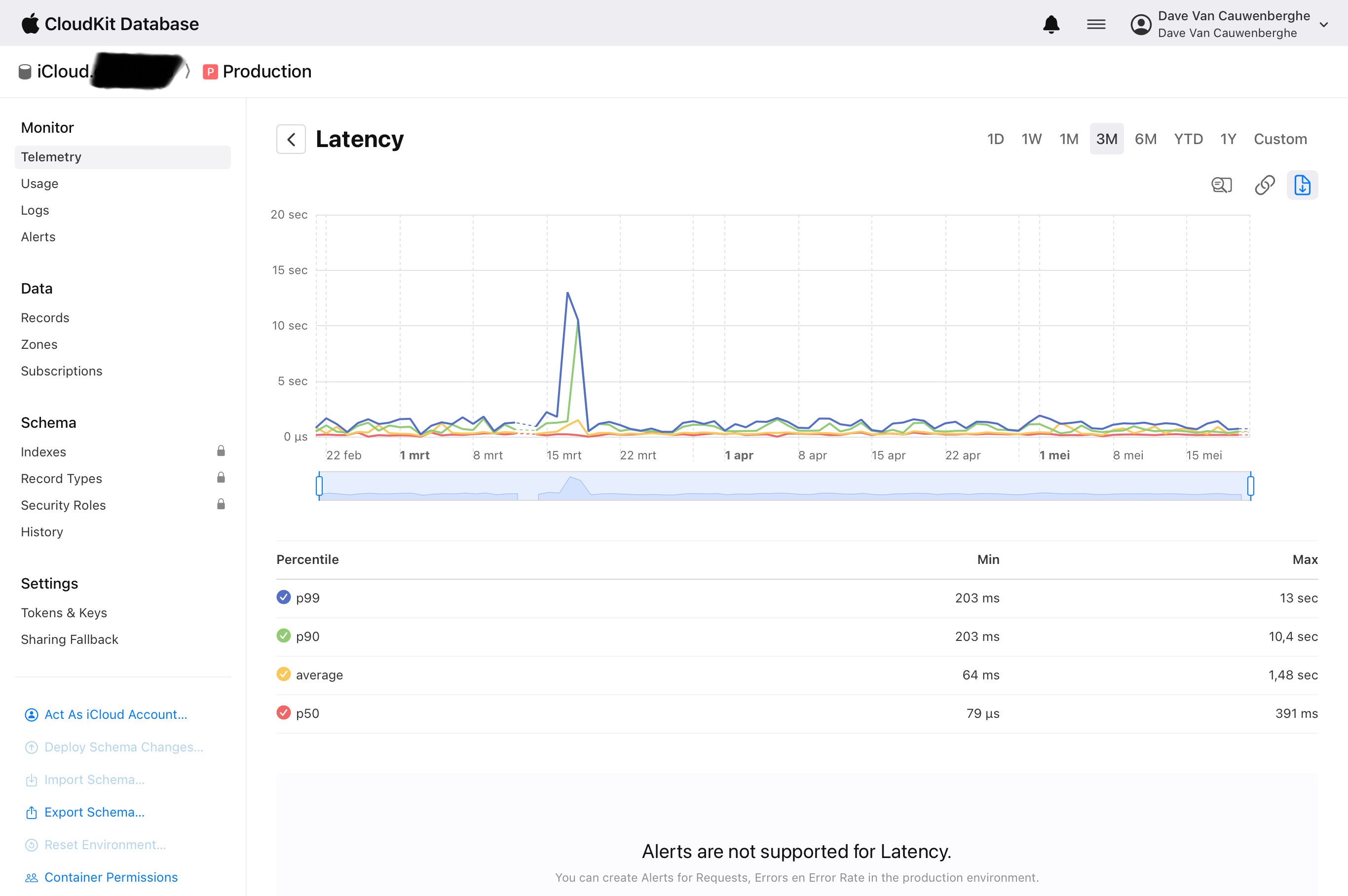

@Aakif Are you seeing a spike in errors or a higher latency in your Telemetry data starting 20. March 2025? I have an increase in bandwidth and latency but cannot correlate the to any code changes I made during that time.
As you posted this message also on the 20th, maybe it is related.
Hi  @alexsteinerde
I also saw a spike around that same time period but it was only temporarily:
