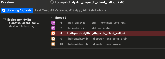

Hi, here's my crash report. Thanks.
Thread 6 Crashed:
0   libsystem_kernel.dylib        	0x00000001f3f832d4 __pthread_kill + 8 (:-1)
1   libsystem_pthread.dylib       	0x000000022d5d959c pthread_kill + 268 (pthread.c:1721)
2   libsystem_c.dylib             	0x00000001aa698b08 abort + 128 (abort.c:122)
3   libc++abi.dylib               	0x000000022d4ff5b8 abort_message + 132 (abort_message.cpp:78)
4   libc++abi.dylib               	0x000000022d4edb90 demangling_terminate_handler() + 320 (cxa_default_handlers.cpp:72)
5   libobjc.A.dylib               	0x000000019fdc72d4 _objc_terminate() + 172 (objc-exception.mm:499)
6   libc++abi.dylib               	0x000000022d4fe87c std::__terminate(void (*)()) + 16 (cxa_handlers.cpp:59)
7   libc++abi.dylib               	0x000000022d4fe820 std::terminate() + 108 (cxa_handlers.cpp:88)
8   libdispatch.dylib             	0x00000001aa5defbc _dispatch_client_callout + 40 (object.m:579)
9   libdispatch.dylib             	0x00000001aa5e65cc _dispatch_lane_serial_drain + 768 (queue.c:3934)
10  libdispatch.dylib             	0x00000001aa5e7124 _dispatch_lane_invoke + 380 (queue.c:4025)
11  libdispatch.dylib             	0x00000001aa5f238c _dispatch_root_queue_drain_deferred_wlh + 288 (queue.c:7193)
12  libdispatch.dylib             	0x00000001aa5f1bd8 _dispatch_workloop_worker_thread + 540 (queue.c:6787)
13  libsystem_pthread.dylib       	0x000000022d5d4680 _pthread_wqthread + 288 (pthread.c:2696)
14  libsystem_pthread.dylib       	0x000000022d5d2474 start_wqthread + 8 (:-1)
Thread 6 crashed with ARM Thread State (64-bit):
    x0: 0x0000000000000000   x1: 0x0000000000000000   x2: 0x0000000000000000   x3: 0x0000000000000000
    x4: 0xffffffffffffd7ba   x5: 0x000000000000001a   x6: 0x0000000000000058   x7: 0x0000000000003fff
    x8: 0x5279bdcbe9c144a8   x9: 0x5279bdca866b34a8  x10: 0x000000000000007f  x11: 0x0000000000000900
   x12: 0x00000000000007fb  x13: 0x00000000000007fd  x14: 0x00000000ec414813  x15: 0x00000000ec2147fb
   x16: 0x0000000000000148  x17: 0x000000016faa7000  x18: 0x0000000000000000  x19: 0x0000000000000006
   x20: 0x0000000000003603  x21: 0x000000016faa70e0  x22: 0x0000000000000000  x23: 0x0000000000000114
   x24: 0x00000003010b1de8  x25: 0x0000000000000000  x26: 0x000000016faa70e0  x27: 0x0000000302be2640
   x28: 0x0000000302be25c0   fp: 0x000000016faa6770   lr: 0x000000022d5d959c
    sp: 0x000000016faa6750   pc: 0x00000001f3f832d4 cpsr: 0x40001000
   esr: 0x56000080  Address size fault
Hmmm, the crash report your attached says:
Triggered by Thread:  6
but doesn’t include the backtrace for thread 6 (just threads 0 and 13). Did you edit that crash report somehow?
