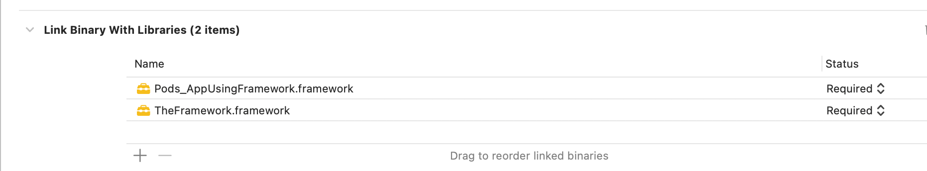

In the Framework's Xcode General section, Frameworks and Libraries contains Pods_TheFramework.framework set to Do Not Embed. In the Build Phases section, in the Link Binary with Libraries section, Pods_TheFramework.framework is set to required.

The App's target has the following linkage settings:
When I build and run the app, there is the following error:

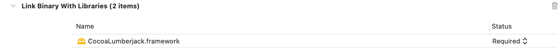

@eskimo @DTS Engineer
FYI Note that this issue isn't specific to installing dependencies via pods. If the 3rd party frameworks are added directly to the parent framework, the exact same issues manifest.
i.e.
