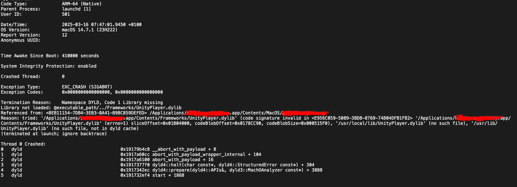

I’ve been having problems with MacOS builds. I’m making a release Appstore build and uploading it to Testflight. However when running it instantly crashes, and report screen shows the following:

It’s not the game, as I can make an enterprise version that runs fine. We have some restricted entitlements, such as Apple Arcade. Building from an M1 mac, and architecture is Universal (Intel + ARM).

  • Only apply these entitlements to executables, not to libraries. That’s generally good advice, but it’s super important when you use restricted entitlements [1].
  • When you update your signing type — Apple Development vs Apple Distribution, say — you have to update your profile. The Embed distribution provisioning profiles section of Creating distribution-signed code for macOS discuss this in detail.
[1] If you sign a library with a restricted entitlement, the trusted execution system will try to find a profile that authorises the library to use the entitlement. This can’t ever work — profiles are tied to executables, not libraries — and that’ll prevent the library from loading.
