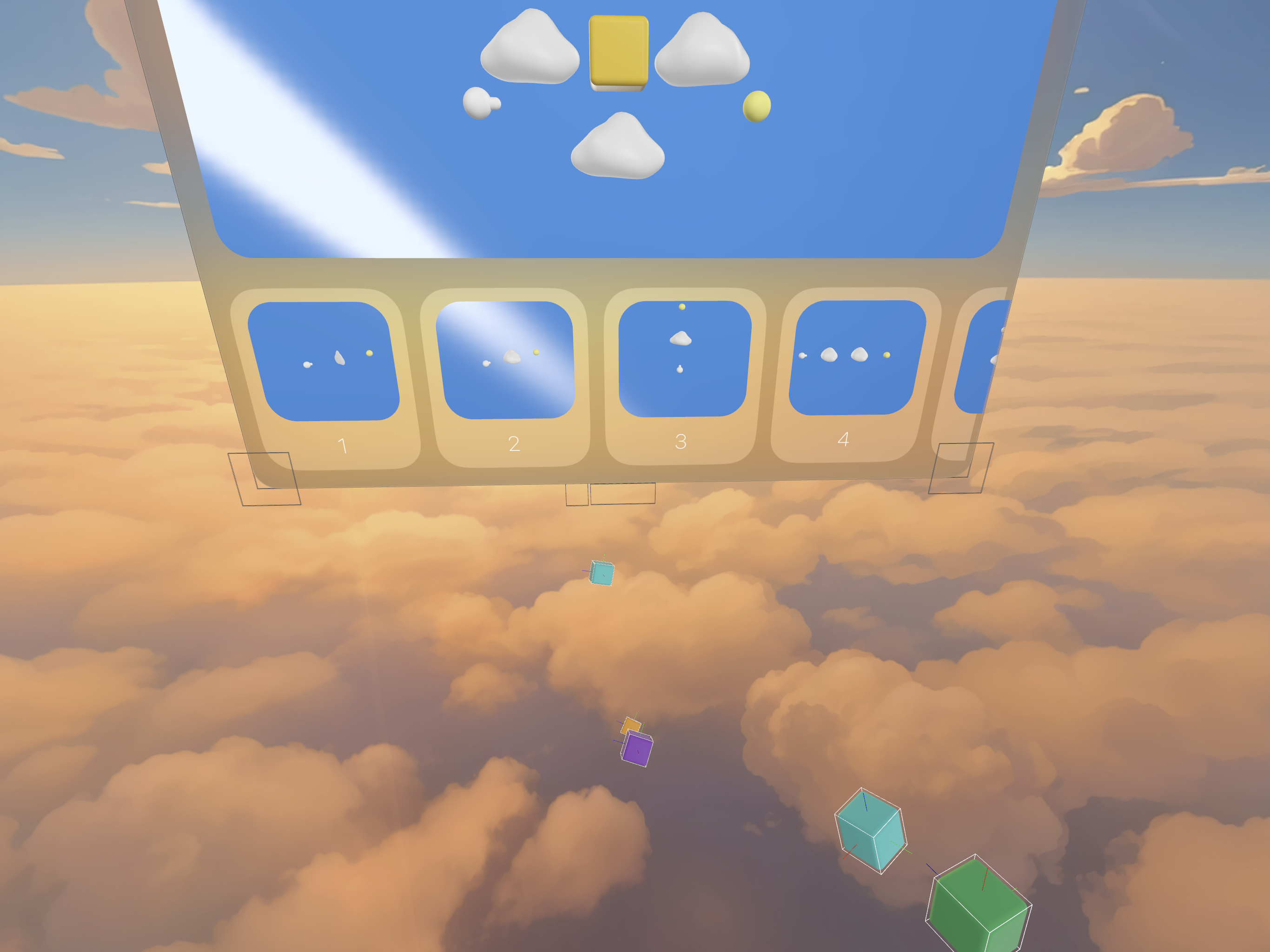

When I show a window while a sky sphere is shown, the handles to drag/close/resize the window are hidden. The colliders still work, so they are there, but only the visuals are hidden. I already know from another project, that this also happens to volumes.
They only appear once you get closer to the window or if the sky sphere gets removed.

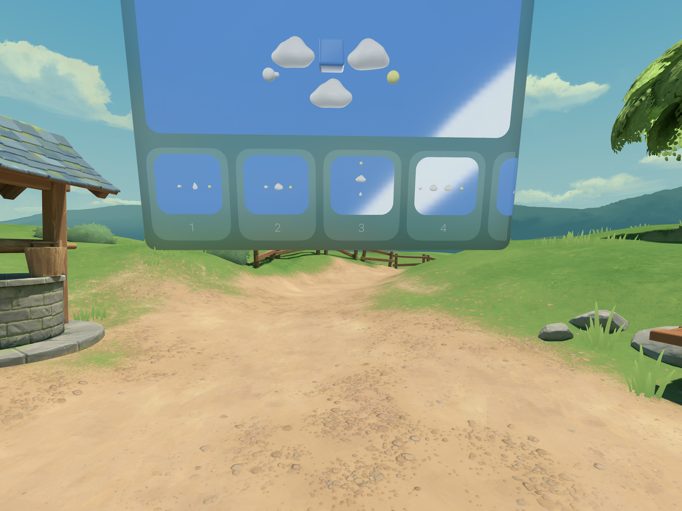

This sounds like an issue with the geometry of your sky dome. I don't see this occurring with the Presenting an artist’s scene sample code or the Immersive Environment App template in Xcode. Could you use the SkyDome.usdz from either of those projects and try again?

You are right, for those two examples it also worked for me.
I tried both domes in my app:
The handles were still hidden. But I just found out if I use .immersionStyle(selection: .constant(.full), in: .full) with UIImmersionStyleFull for UISceneInitialImmersionStyle, it suddenly works. So it seems they are hidden with everything set to .mixed - but again, in the examples you mentioned, everything still works with .mixed as well.
