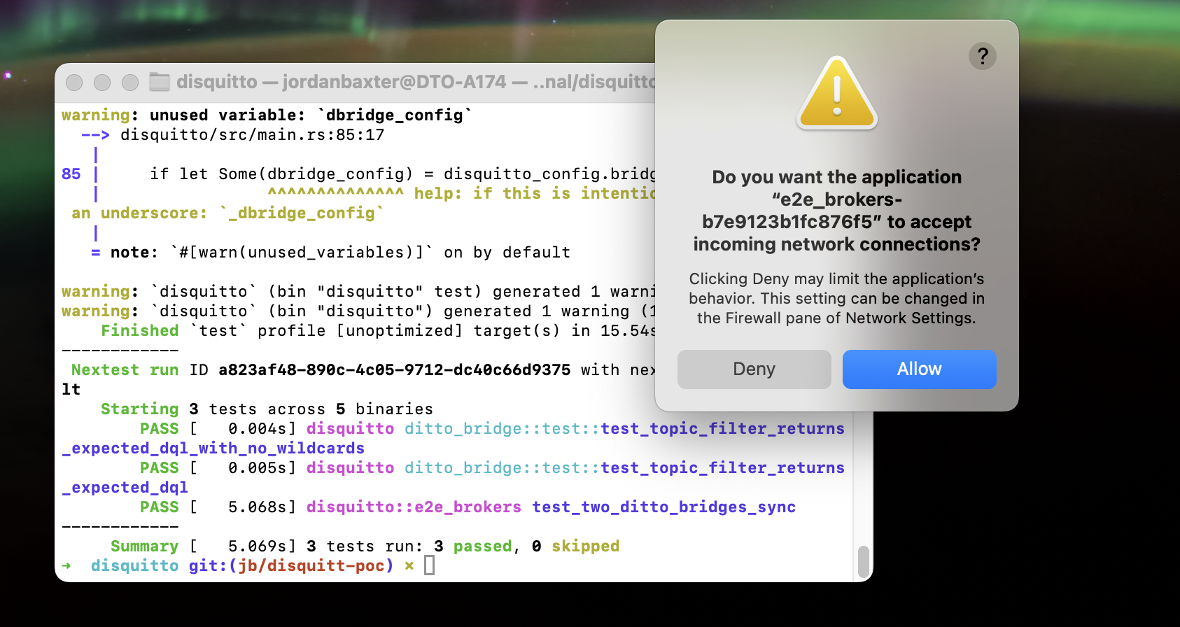

Here is a screenshot of a test I am running from the terminal that uses localhost networking to connect two MQTT brokers running in the same process through a custom networking backend. At the lowest IETF level the custom networking backend is using QUIC (udp). There are some additional mDNS shenanigans going on too, in case multicast is the issue.
I see that this pop up is firewall related, which I'm unsure has to do with the Local Network Privacy feature. But this pop-up is new with the new version of macOS.
This has nothing to do with local network privacy. None of the advice in TN3179 applies to this issue. It’s just a coincidence that we also updated the firewall in macOS 15.
You have two options when it comes to firewall issues:
  • Turn it off.
  • Sign your code correctly.
The firewall isn’t particularly valuable security-wise, so I generally just leave it off. That’s a reasonable option on your development machine, but you will have to solve this problem when you distribute your product because you can’t ask all your users to turn it off.
The firewall tries to remember the user’s choices, so that the user doesn’t have to keep clicking Allow or Deny. To do this is needs to be able to identify the code, so it knows that the current build of your product is the ‘same’ as your previous build. It does this using the product’s code signature [1].
To resolve this issue, sign your code with a stable code-signing identity. I general recommend an Apple Development code-signing identity for day-to-day work. For distribution, you have to use an identity that’s appropriate for your distribution channel [2].
Once your code is signed correctly, the firewall should remember your Allow choice and you won’t see this alert again.
