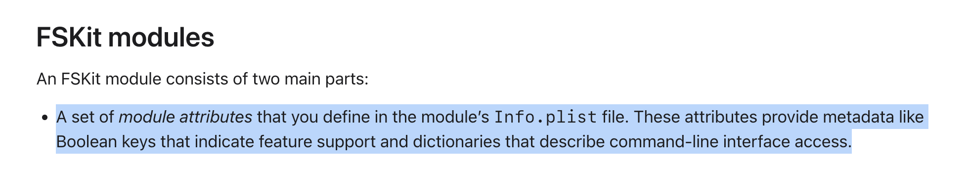

Is there any actual documentation about the attributes it suppose to go into Info.plist?
From the template it seems there is a bunch of them but without documentation it's really hard to tell what are the OptionSyntax ones do...

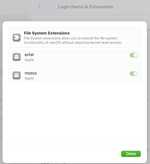

Also it looks like out of box on macOS 15.4, this it not working given -[fskitdXPCServer applyResource:targetBundle:instanceID:initiatorAuditToken:authorizingAuditToken:isProbe:usingBlock:]: Attempt to start disabled extension...
I had to manually add my extension bundle identifier to enabledModules.plist to get it to load... which doesn't seem right 😛

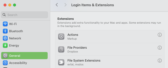

FSModule enablement is controlled from System Settings -> General -> Login Items & Extensions and then the info button to the right of "File System Extensions"
