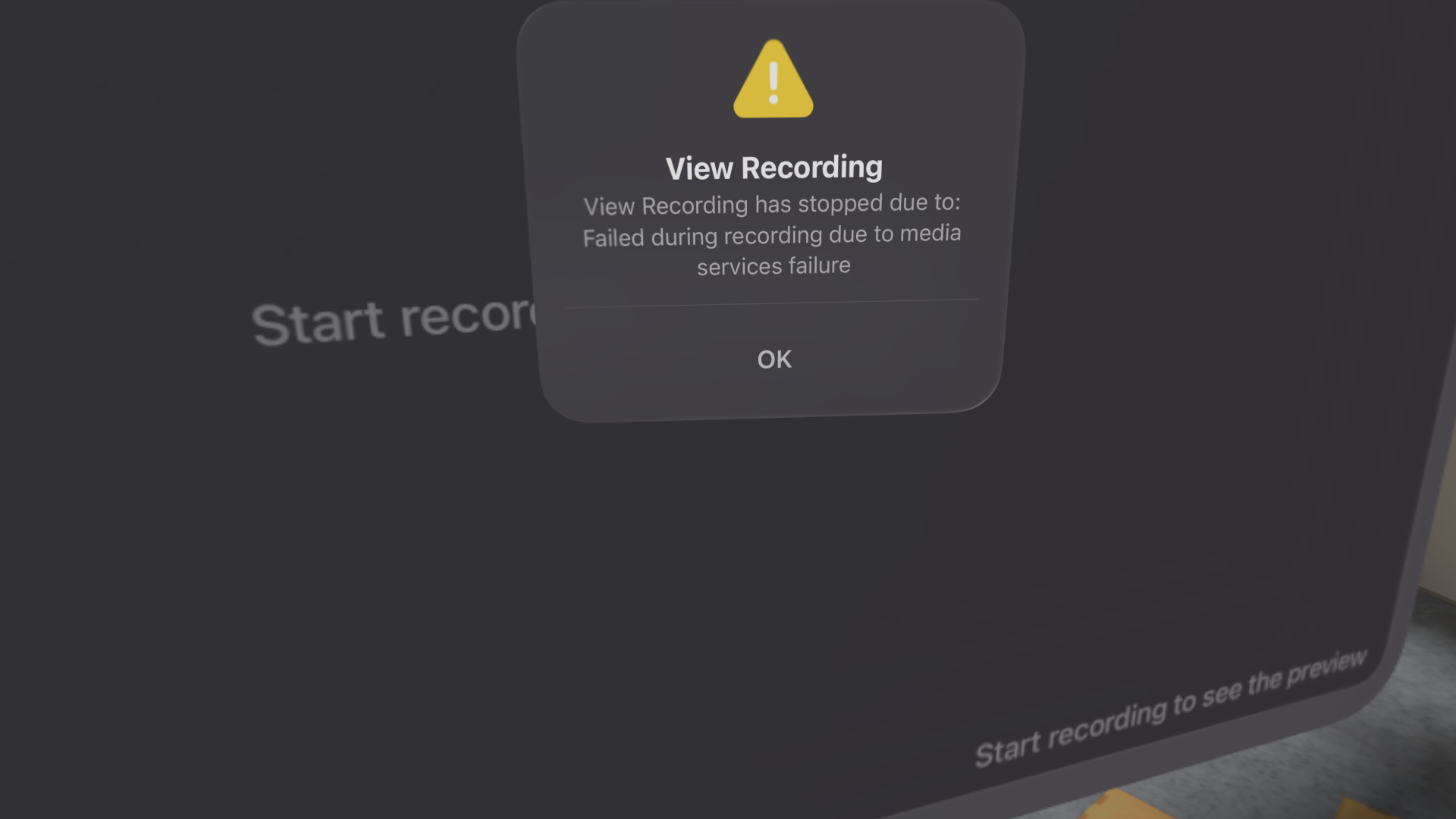

Hi, I'm developing a virtual camera system using ReplayKit to capture scene video by directly accessing raw video buffers. The capture mechanism works flawlessly when repeatedly starting and stopping video capture within a continuous immersive environment. However, a critical issue arises when interrupting the immersive space:
Step 1: Enter immersive environment and start and stop capture videos(Multiple times with no issues) Step 2: Press the crown button to exit the immersive environment Step 3: Return to the immersive space subsequently Step 4: Attempt to start the video capture
At this point, the startCapture method throws an unexpected error, disrupting the video capture workflow.
This is the Xcode error that I see " [ERROR] -[RPScreenRecorder startCaptureWithHandler:completionHandler:]_block_invoke_2:500 failed to start due to error: Error Domain=com.apple.ReplayKit.RPRecordingErrorDomain Code=-5803 "Recording failed to start" UserInfo={NSLocalizedDescription=Recording failed to start}"
I have tried all possible ways to stopCapture including OnDisappear and other methods and nothing seems to solve this.
