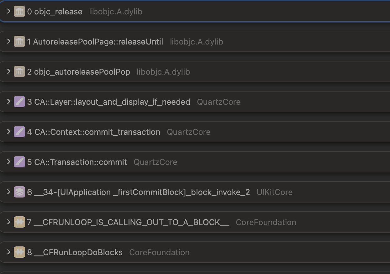

On the Swift side, I create an MTKView. Inside the MTKView delegate, I run the emulator for 1 video frame and pass it the view's backing layer for it to render the final output image with. The emulator runs and returns, but when it returns I get a crash in Swift land (callstack attached below), inside objc_release, which indicates I'm doing something wrong with memory management.

This is the Swift callstack at the time of the crash:
To my understanding, I shouldn't be violating ARC rules as my bridging header uses CAMetalLayer* instead of void* and Swift will automatically account for ARC when passing CoreFoundation objects to Objective-C. However I don't have any other idea as to what might be causing this. I've been trying to debug this code for a couple of days without much success.
