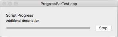

A progress meter (in any AppleScript) should be a straightforward thing i.e. I can clearly define a total number of steps and I can clearly define the step number I'm currently on. I just want to display something like:

I just noticed something. I've been saving this AppleScript as a workflow in Automator so that it's accessed via the Services menu. When I run it that way I do NOT get a progress meter. However, if I save the AppleScript as a stand alone app and run it that way I DO get a progress meter. Is there any way to make the progress meter appear if initiated from the Services menu?
How the built-in progress indicator is shown is dependent on what is using it. For an Automator workflow or a script from the Script Menu, the progress is shown in a status item menu by the system's ScriptMonitor application. For each process it just has a menu item with a circular progress indicator and descriptive text, but note that for an Automator workflow the progress is for the workflow itself - e.g. how many actions have been completed.
