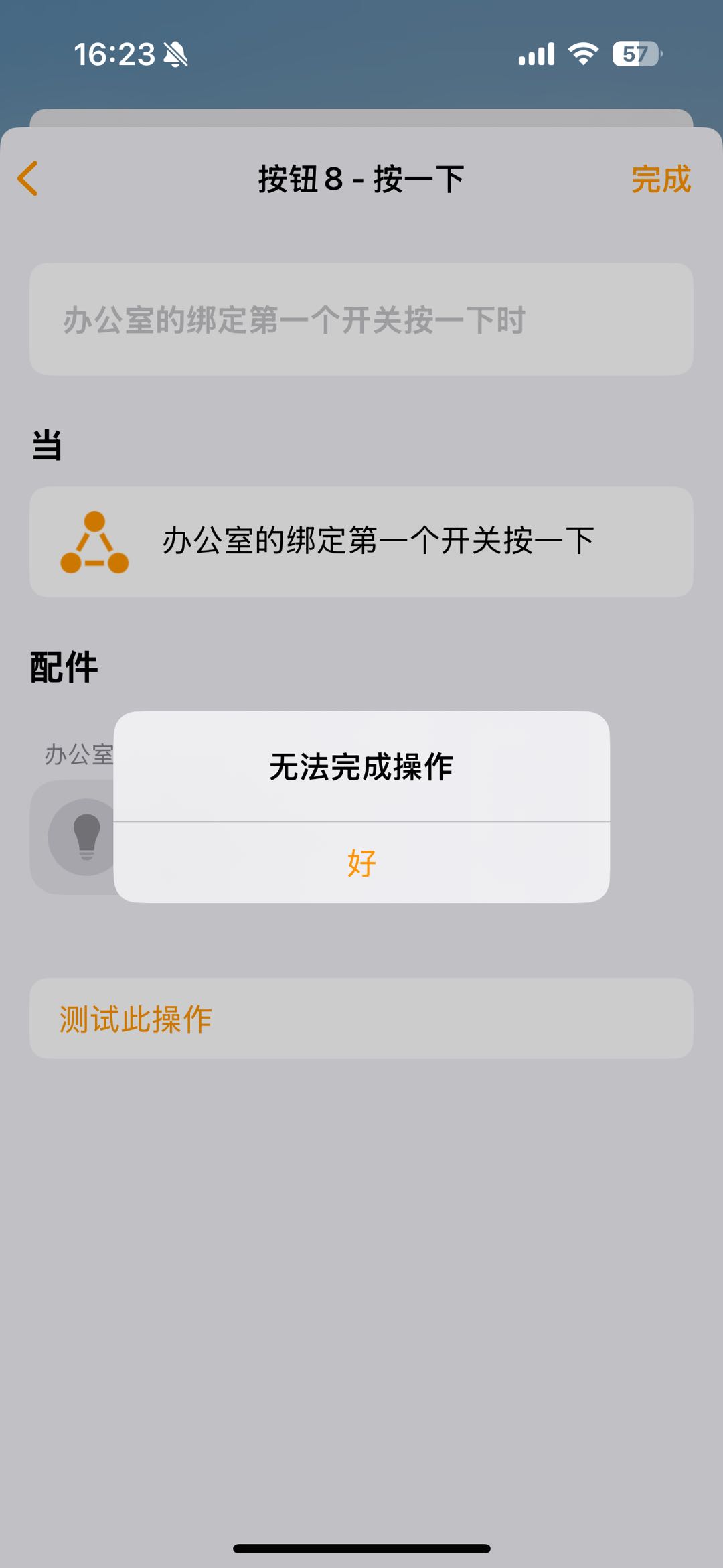

I use Homepod Mini as the gateway and have bound 9 Matter lights and 7 Matter switches. Each of my switches has 12 buttons, and each button supports three functions: single click, double click, and long press. Therefore, a total of 252 actions can be configured for 7 * 12 * 3. Currently, a total of 71 actions are configured for the 7 Matter switches. When configuring the 72nd action, the app will prompt that the operation cannot be completed. But if you delete a few previously configured actions, such as 68 actions, then you can configure 3 more actions (69, 70, 71). However, as long as you configure the 72nd action, the app will prompt that the operation cannot be completed, as if the available space is occupied. What is the reason for this?
Configuring the 72nd action for the Matter switch on AppleHome will fail
Is that error dialog coming from Home.app or some other app? That screen doesn't quite match Home.app and, more to the point, I wouldn't have expected us to return a generic error like "Unable to complete the operation" for basically ANY operation. Having said that:

...the answer is almost certainly that you've hit one of HomeKit's existing internal limits, probably the limit on HMActionSet's per home. The actual limit is "100", however, there are system defined action sets and the mapping from Home.app's interface to the HomeKit API is not straightforward, so I suspect there are another 28 HMActionSet's "in play" that you aren't aware of. In terms of verifying the specific issues, the two things I would look at are:
When does HMActionSet.addActionSet(withName:completionHandler:) fail and what error does it return? I'd expect it to be returning "HMErrorCodeMaximumObjectLimitReached" and I'd need to look into any other error.
Once you hit the error, what does HMHome.actionSets return?
