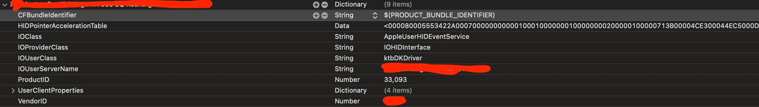

@Engineer I made this:
And I use the previous method to adjust the acceleration, seem nothing happen. Please advise.
Please see my code piece:
